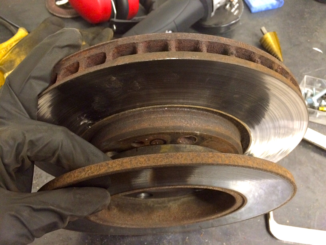

Those stock lil' 4k rotors are cute little buggers but I'm happy with 50mm more rotor and much more girth

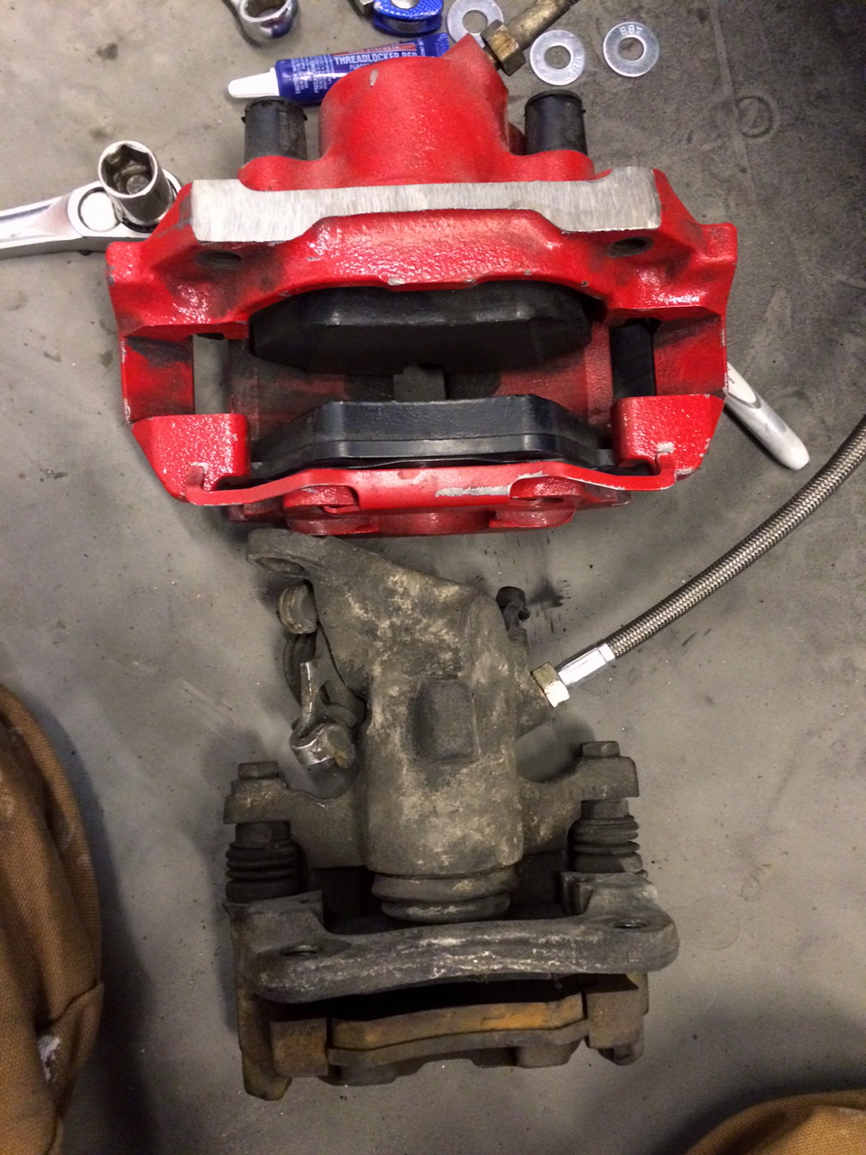

E30 M3 front caliper vs rear 4kq caliper

Conveniently, the brake lines all matched up no problem.

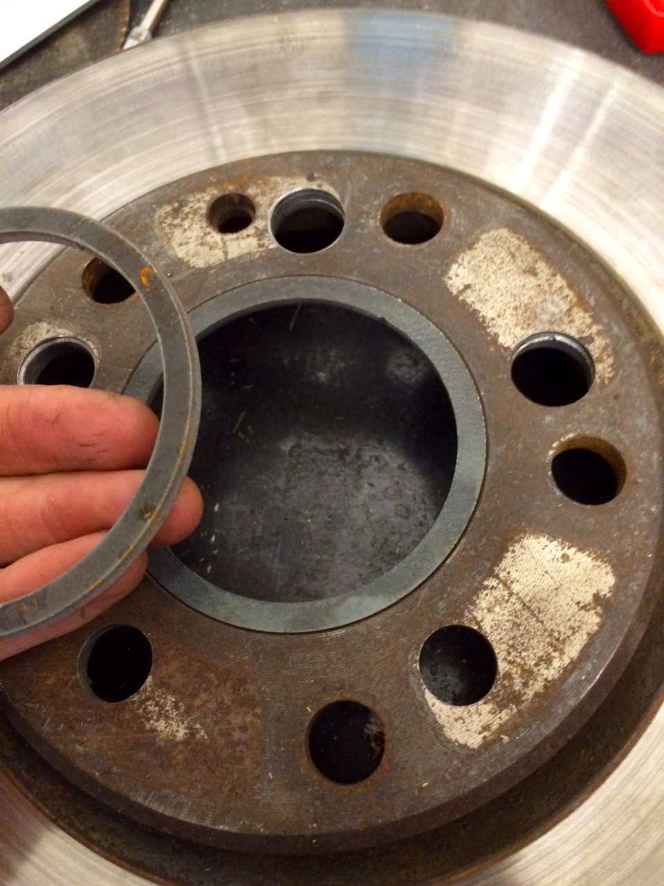

I also redrilled the 5x120mm BMW rotors to 5x112mm Audi. After taking 20 minutes one day to try and line up the non-hubcentric bmw rotor (bigger hub bore) and the non-hubcentric OZ's I decided I needed some centering rings for the rotors. What I REALLY need is to do wheel studs but I don't have time for that right now. I'll order some up next week.
For now, I had the local waterjet cutter make some rings for my BMW rotors. I welded them in place and whammo, hubcentric rotors!

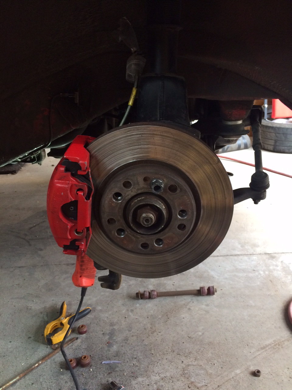

I'm up against a deadline with track day tomorrow, but I'll eventually pull those calipers and paint them black to match the Porsche brakes up front.
Here's a pic of the finished product in the rear. Looks good and stops even better. Hells yeah.

Re: 4 FOX SNAKES - Ross' 20vt 4kq
Looks great! I was starting to wonder what happened to this. So with useig front calipers on the rear, you have no ebrake. Are you planning to use a hydrolic ebrake?

Ya, I'll figure out an ebrake at some point. Probably go hydraulic but I don't know anything about it right now. Once I have time I'll start to do a bit of research on it. My E30 M3 has had ebrake delete since the day I bought it 4 yrs ago (it was a track car so P/O removed the ebrake so the pads wouldn't melt to the rotor) and its really not that big a deal. Plus now I drive around with harbor freight wheel chalks if I need something in a pinch.

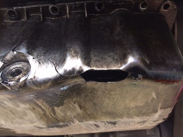

Then the next morning this happened. The wife hit something in the TDI wagon and kept driving... Literally less than 12hrs after the Audi motor went south.

oh man, major bummer!!! I've never liked the idea of the push lok hose!
Did the TDI survive? i broke my TDI pan this year and it ran out of oil and it was totally fine. However, I shut it down the millisecond the oil buzzer went off. Those pans are horrible, so easy to hit and so damn flexible.

New oil pan showed up yesterday afternoon for the TDI. Its fixed and the motor is all good. Finally some decent news
