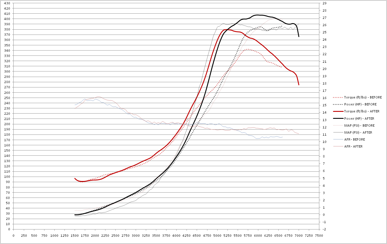

Jamo look at the dyno plot above - that isn't even with the QSV all the way open, just opening too early (blue line). HUGE difference. The difference could be so large because the hotside is too large in the first place, but we are going to do some water/meth tuning and decide from there whether a hotside housing swap is needed.
Re: Pops' 1997 S6 2.5L Stroker - 407whp/390wtq @28psi *VIDEO
definitely works from what I have seen on this car. See the overlaid graphs from a page or two back.

Before/after dyno comparison (note the quick spool valve was opening way early on the base pull):

You should be making a bunch more power lower in the band.
Neil P's stroker S6 in Cranberry,PA crosses the 270lbft mark at 3500 rpm and peaks 419lbft at about 4450rpm. That's on a 30R without a QSV using an EPL tuned factory ECU and limited to 24psi peak. In perspective you're showing everything happening 1000 rpm later with a setup thats not far from Neil's and you have the benefit of a QSV and VEMS.
Admittedly Neils car was tuned at sea level in an early CT spring but the point is you should be spooling much earlier with the QSV. I'd expect you to be spooling slightly earlier than Neil. I know you have a lot of tuning to go so lets see whats really possible on your setup. I wanna see a real under peak tq band dammit. :-)

First, I believe Neil's car is a 3071 - at least that is what he has told me on multiple occasions, one of which was at SFest a few weeks ago (maybe he is mistaken?). Second, Marcel's turbo is way, WAY larger, not even close...it is bigger than a 35R.
Given the size of that turbo the spool is impressive as-is.
