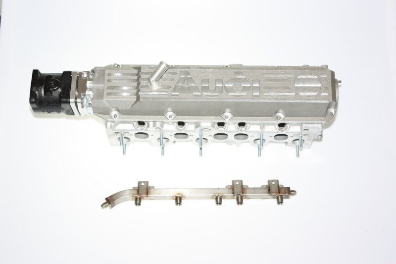

I like the deck cooling idea, but not sure there is enough material at the top of that block to do that, try a bunch of brass fittings with small tubes I think you will have better luck.. :-)

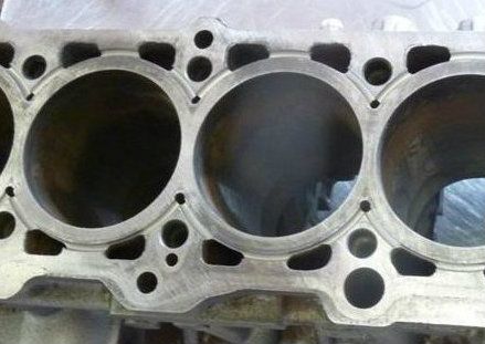

Don't be so quick to doubt. The additional ports on the outside, like shown above, would do little more than the stock turbo water neck for the 20V.Twintowers wrote:I like the deck cooling idea, but not sure there is enough material at the top of that block to do that, try a bunch of brass fittings with small tubes I think you will have better luck.. :-)
You want to get the water as close as possible to the source of heat and the only way to do it is with deck cooling...you increase the dT/dx and subsequently the heat transfer rate as well. This does 2 things. 1-It can remove more heat for high power applications, but it also will improve the temperature uniformity in the head (reduce hot spots), which is also a good thing.
Also, I am building a 20V motor here and there is plenty of material left to do it. Many others BTDT. Both my measurements and the solid model support this. It has also been done many times on the 20V head and block with good success. If you look at even newer VAG motors, many include a cooling jacket around the combustion chamber.
The model I posted above really doesn't have the full deck geometry captured, so it is not really indicative of the clearances on the deck. It was mainly to set up the CNC code for machining the groove. I will be detailing it further, but it isn't required for this exercise.
For reference, here is a machined block showing plenty of meat available...
and here is a new VAG I5 showing the factory cooling on the head...
The head groove can be the same dimensions as on the block. This head will still have the turbo water porting, so don't think I'll be adding anything like that picture. The machining to do the deck cooling modification is super simple...and what the works motors did on the cross flow 20V.
The real question is whether there is any benefit in my application.

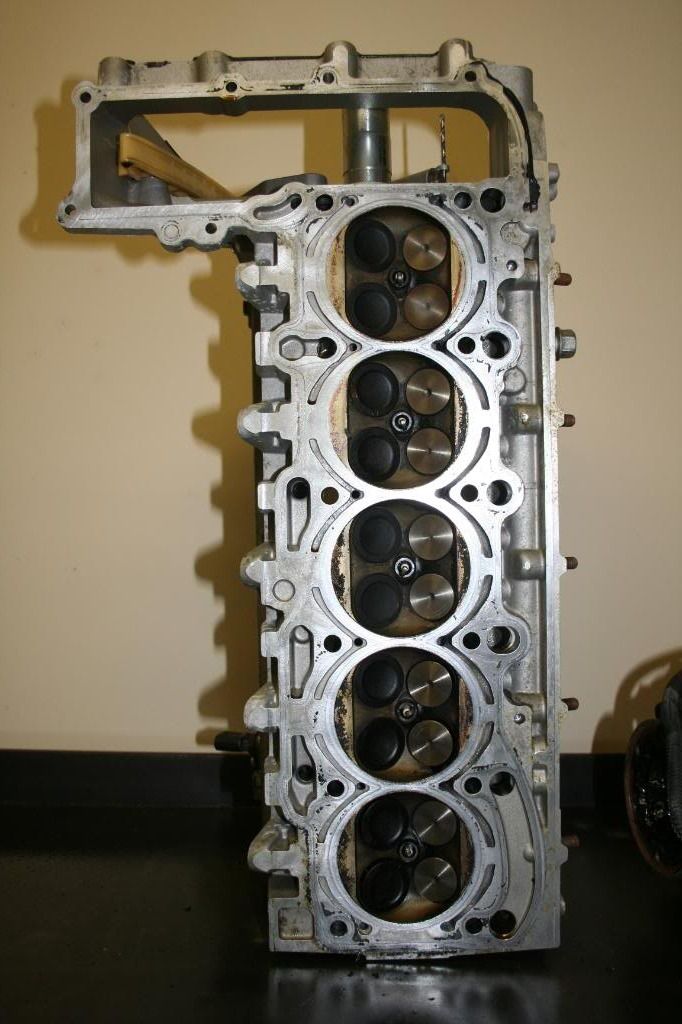

I decided to do a test run on a damaged head to keep from damaging/destroying any of my good 20V heads.
I've scratched my head a few times trying to hypothesize the particular failure with this one. This is the head that came on the urs6 parts car that I picked up a few months back for a song. The story that I was told was that it recently had a head job, and then proceeded to crunch an intake valve on cylinder 1 within a few thousand miles. I would assume that the timing belt jumped or something, because it doesn't really make sense to just drop an intake valve...at least not like a sodium exhaust valve can.
When I pulled it apart and pulled the valves, I noticed something that I couldn't believe. This freakin' head had been skimmed (it was definitely freshly decked, as I could see fresh tool lines) with the intake valves IN THE HEAD! If you've looked at many 20V heads, the intake valves are .030" proud or so when seated. I can't say where they sit on a new, unskimmed head as I'm not sure I've ever seen one, but all of the heads I've come across have been this way. I am in the process of trying to uncover the factory specs/dimensions on these heads so I can tell how much some of them have been skimmed, and be able to work with them a bit better.
So here are the intake valves that I pulled, minus a broken one and a bent one from Cyl.1...
What kind of machine shop does crap like this? I'm pretty sure I know the repair shop that handled the repair, but they likely outsourced the head work to another shop. Unbelievable.

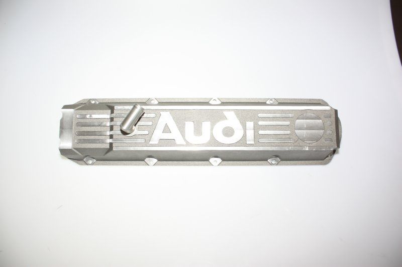

I would pay lots of money for that valve cover... any idea where I can get one??Twintowers wrote:I like the deck cooling idea, but not sure there is enough material at the top of that block to do that, try a bunch of brass fittings with small tubes I think you will have better luck.. :-)

You will need to ask Martin who makes these, as I can't find the records, only the pictures. But these are produced in Europe, along with other very cool and expensive parts.impretzle wrote:I would pay lots of money for that valve cover... any idea where I can get one??Twintowers wrote:I like the deck cooling idea, but not sure there is enough material at the top of that block to do that, try a bunch of brass fittings with small tubes I think you will have better luck.. :-)
