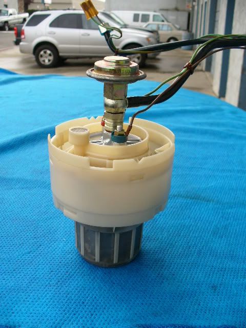

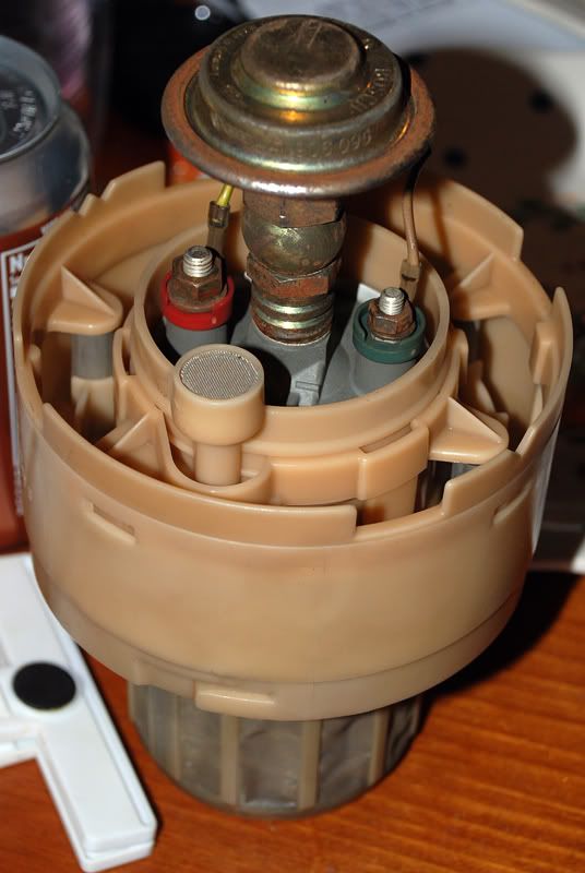

$20 sounds fair to me but I just want to make sure it does fit the 044. Maybe a pic or something. I'll look around for fittings today.
Nick
'00 A4 1.8t
'91 200 20v
'91 200 20v Avant
Re: AMD's 91 200q Project
First one is a V8 pump (the one I have in my car now)
Second one is a 200 20v pump (just like the one I took out of my car for diagnosing some stuff, but it turned out to be good still). This is the basket you'd be getting.
Third one is 034's 044 drop in thing. Looks like the same basket.

Ok, looks good to me man! Let me know how you'd like the payment and I'll send it right over. If you'd happen to have any of those spare fittings I could use them too. If not, no biggie. I can prob come up with some.

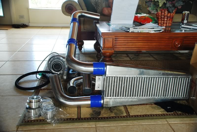

I came up with a new idea for my intercooler today. Anyone ever check out Bell cores? They'll make you any kind of custom intercooler you can come up with. I'm sticking with using basically factory IC routing and plumbing with silicone couplers of course. I am going with a 4.5" X 7.7" X 18" core and they even assemble the endtanks in several different routes/size inlets/outlets, weld it all together and pressure test everything.
Check it out:
4.5" cores (mine is A450077180): http://www.bellintercoolers.com/pages/aachart450.html" onclick="window.open(this.href);return false;
Tanks (style D for the left and Style A for the right): http://www.bellintercoolers.com/pages/AATank.html" onclick="window.open(this.href);return false;

I forgot to mention in out PM that if you aren't set on that company, check out Treadstone. The cores have very good fin density, good end tank design, and are quality overall BUT much cheaper than Bell. I think Bell is damned good, but just throwin out other options. Also consider a vertical core because you'll get better cooling with the space constraints of the 200. Check out my setup. This is basically how I did it, not exactly though. I'm sure you get the idea.
also, if you need good, cheap piping look no further than CX racing. Yes, they are mostly cheap ebay shit, but their piping is pretty damned good. All of the piping you see in that pic and all of the aluminum piping I've ever used is from them and it welds nicely, is nice and thick, etc.
Big 2nd on both accounts - Treadstone & CXRacing. Nothing more to add to what loxx said.
