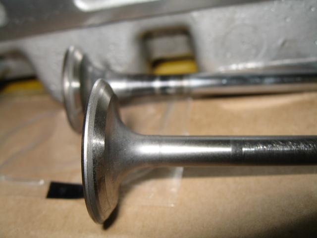

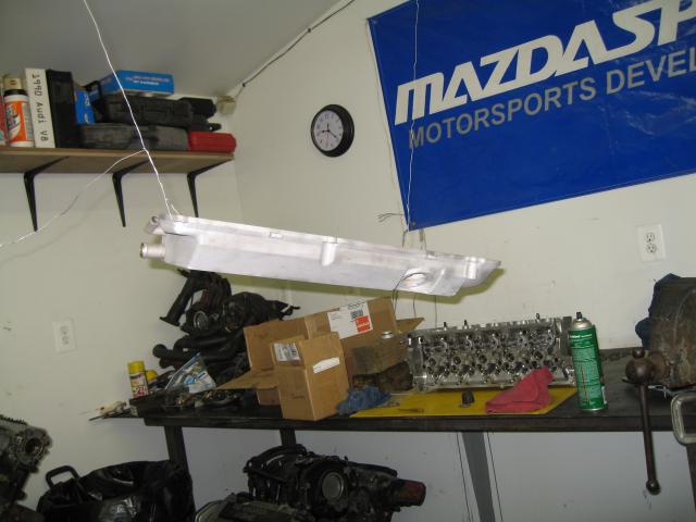

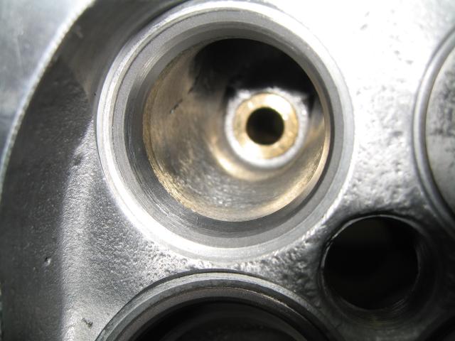

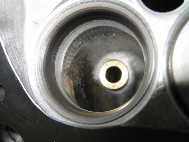

Update, got the head back from the machine shop and took the day off from work today to put the valvetrain back together and prepare a few other things.
some shots of the seat work:
I was going to do all the re-assembly at Haydn's shop on Thursday, until I realized that I forgot the valve stem oil seals at my house :bashtard:
So instead, I powdercoated my valve cover :-D
Haydn was busy playing with my new boroscope (I had 'tool envy' after borrowing Javad's, so I had to have one :) )

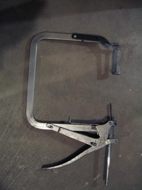

I borrowed his valve spring compressor (:thanks:) to finish the job at home, it works really well, even better than the official audi tool that bolts to the cam cap studs, IMO.

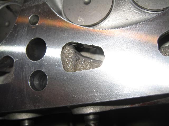

I even put my father to work doing some port work on the hot side housing
fixing up an 'oh fvck!' moment a few years ago when I had to helicoil a broken stud while installing the RS2 EM and ended up drilling into the water jacket (dont ask). I was able to seal it up at the time by packing the tip of a cut EM stud packed with JB at the end of the stud hole but after pulling the stud and pressure testing it was leaking into the cooling jacket. JB weld to the rescue from the back side now that I have access ;)

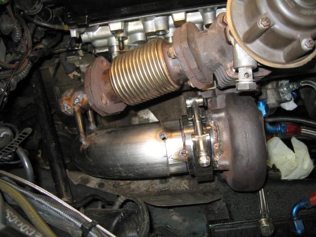

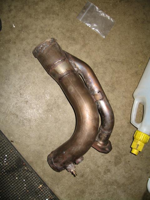

Alright, more progress from Sunday and today. I got the head back on the car and then had a fight with my Stromung downpipe. It lost :-D
The Stromung has a transition from 2.5->3" after the wastegate pipe junction and I really needed it to start at 3". I ended up keeping the bottom portion of the downpipe and re-using parts of the wastegate tube but the rest of it was all re-done. I'm really happy with how it came out since now there is MUCH more clearance against the tie rods all the way around. Spent all day routing it the way I wanted but it came out pretty good.

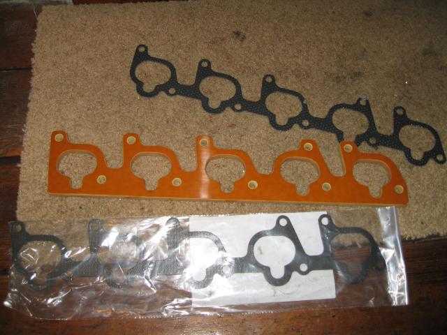

Decided to go with a phenolic spacer from Vast Performance while I was in there:

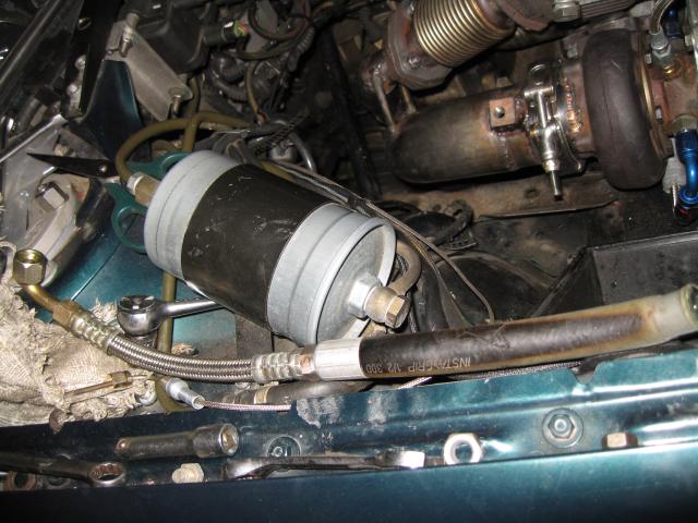

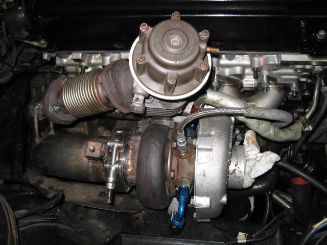

downpipe has been finish welded, added a bung at the top for an EGT probe (o2 port is at the bottom to help keep the sensor cool).
Turbo is in, lines attached. Not much more...
Looks like my coolant hose under the turbo got a little cooked, probably from when the stud backed out and the gasket blew a hole in the bottom... Hose is very brittle in the middle and looks a bit like a hotdog left on the grille for too long. I had enough parts to make a new hose tho. Fire sleeve is going on this time ;)
