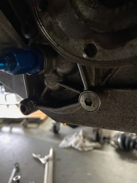

Posted: Thu Mar 09, 2023 7:00 am

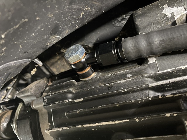

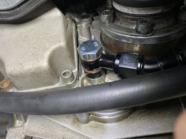

by rennenmsports
I used a counter sink bit to be able to use a flat headed taper bolt so I can install a -10an banjo fitting for the transmission cooler

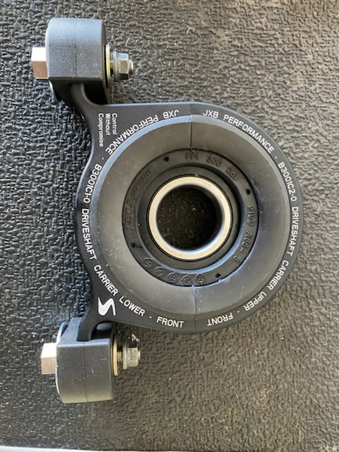

Rebuilt prop shaft center support
Bearing from McMaster carr 4668k295 works

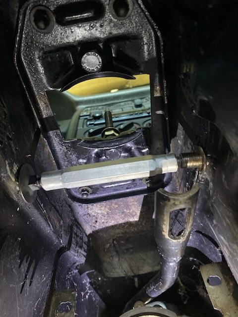

I figured out a simple way to strengthen the push rod on the clutch master. I just stacked up nuts and grinded one down to meet the necessary adjustment

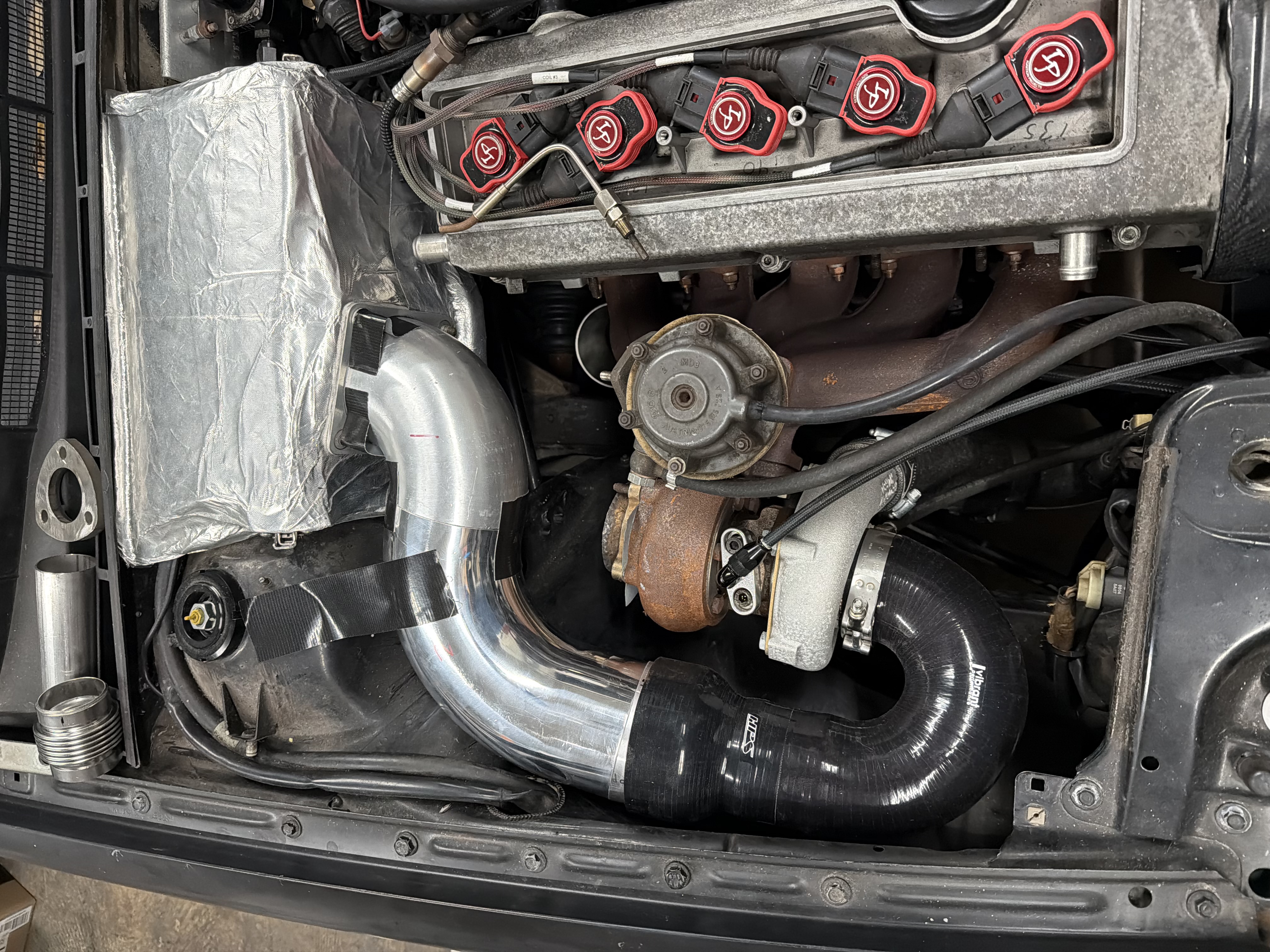

by rennenmsports
It started misfiring pretty bad. It has Amazon coils. So I ordered Okada coils for the ttrs in hopes that it stops the issue. I also previously relayed the coils with a 50A/30A relay. It was getting pretty warm so I ordered a 70A replacement. When everything gets here we’ll see if the problem goes away and we can finish tuning it. I got the hood on. Had to drill holes in it for the exhaust. Fortunately I have a new one in Delaware.

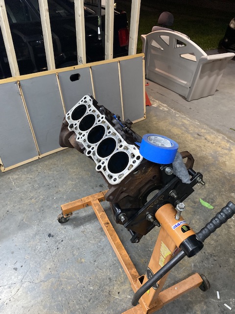

The new coils solved the issue only it lost a lot of compression due to piston ring failure. I finally am able to start removal and disassembly of the entire engine this time.

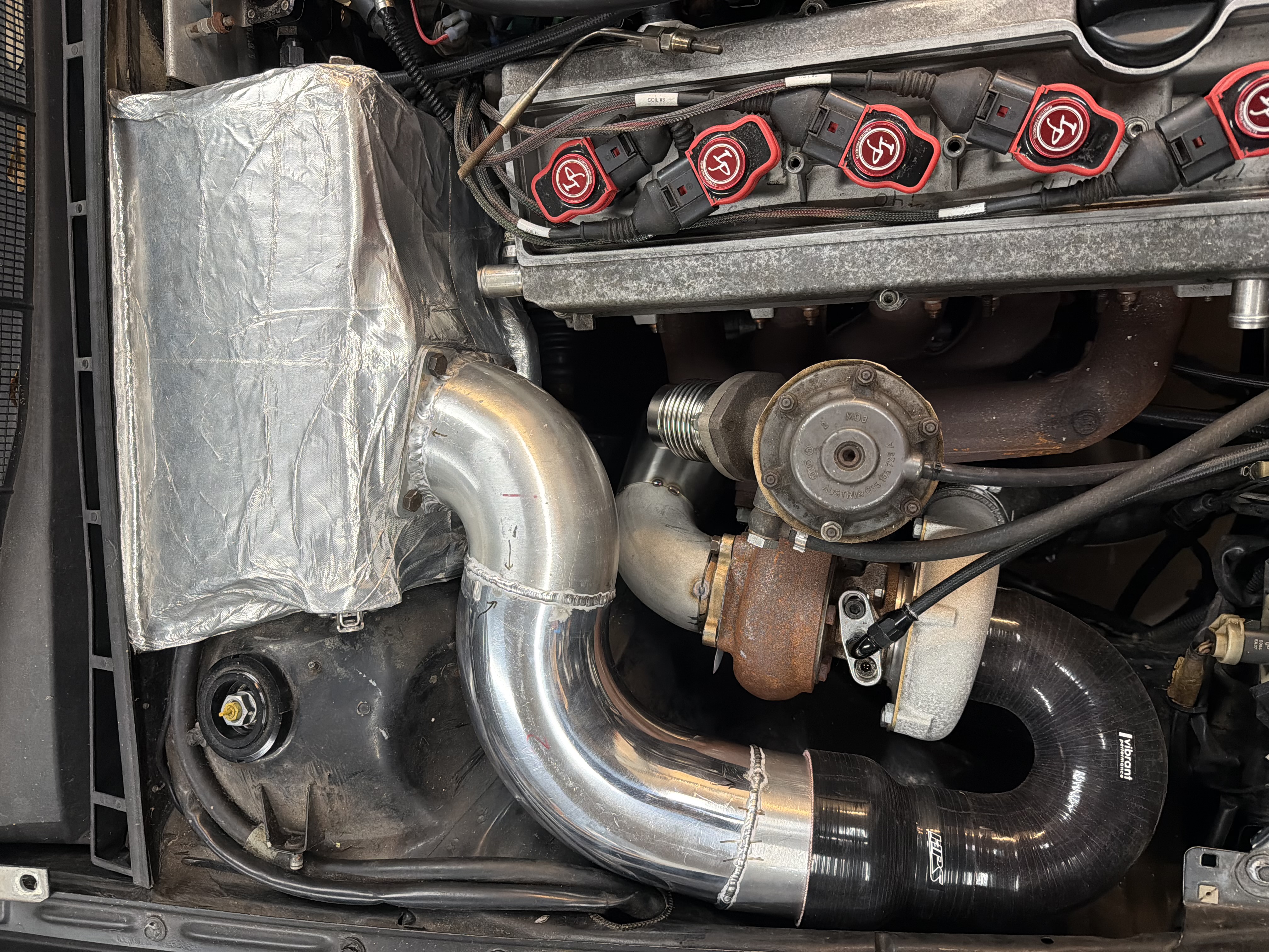

by rennenmsports
I pushed her back into the garage on the first. Happy new year everyone. for the third time around. This time I’m getting a short block professionally built. Didn’t have much luck the first two times. I’ve gotta make the intake and exhaust first so we can tune it properly. The intake tubing was easy. The down pipe on the other hand won’t be. I’m using 2 1/2” schedule 10 304ss pipe.
Re: Andy's 91' 80q
Posted: Mon Jan 12, 2026 12:43 pm
by rennenmsports
Re: Andy's 91' 80q
Posted: Mon Jan 26, 2026 6:15 pm
by rennenmsports
Making a downpipe is much more difficult than I thought. A new found respect for fabricators. Here’s what I got so far.
Re: Andy's 91' 80q
Posted: Tue Jan 27, 2026 9:27 am
by rennenmsports
It fits :D
