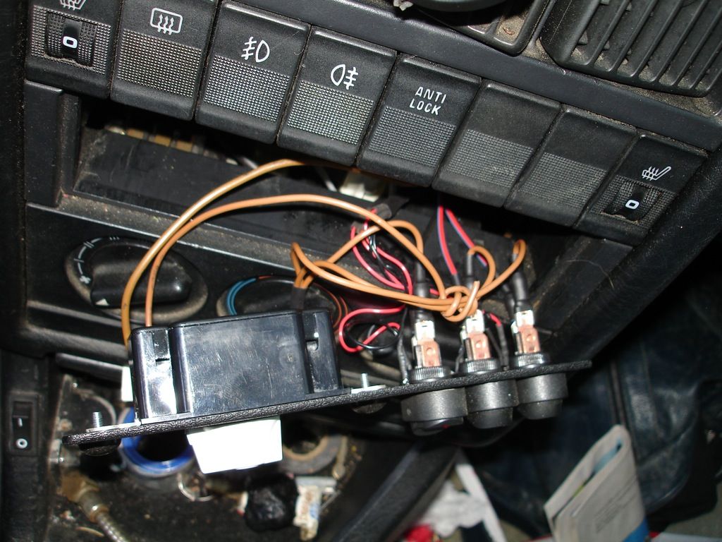

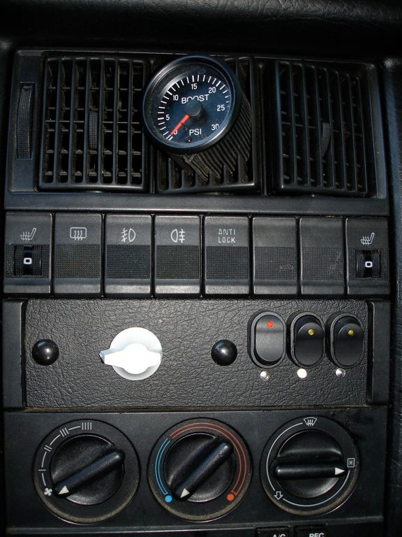

The mileage is creeping back up; 47.7 last tank. This current tank is 520 miles still touching the half tank mark. This might be the record breaker. I raised the boost to 15 psi, set the pump timing to .945mm, changed the LDA boost diaphragm adjustments to decrease and delay fueling onset slightly. I finished my afterglow timer circuit last month and it works exactly as planned. I used a 5 minute mechanical timer switch, a large terminal 50 amp relay from an ABS pump, and a lighted rocker switch. I have an LED wired to the glow plug harness so I now know when the plugs are actually on. There's 2 other switches wired to relays for the coolant glow plugs for quick heat and warm-up in the very cold weather (like last winter). I'm leaving for Carlisle in the AM for the first long trip in the "oil_can" over 100 miles. See you all there.
