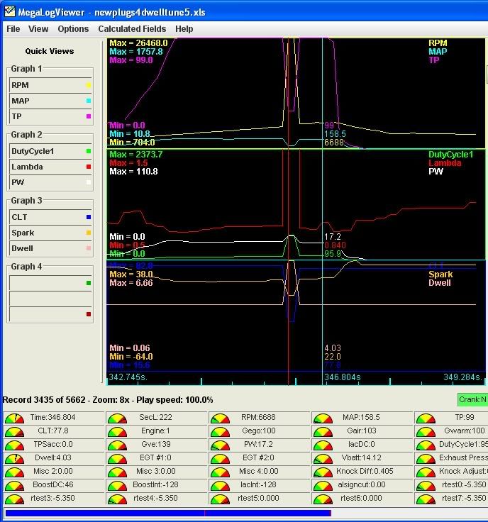

pitten
Er, OK so I threw some BKR7E's in just for the hell of it to see what they'd do before I spend $17 per plug.
First run I did (and didn't log) was with the BKR7 plugs (gapped to .026) and the same exact settings as the previous logs. Same result. Two misfires. One somewhere in the 5k range, and one shortly thereafter somewhere in the low 6k range.
Next I tried a new map. Only thing changed besides a little fuel tweaking was 4ms of dwell. It was previously 3.5ms.
The car responded well to this. It pulled very cleanly up until about 6700 where it had a hard misfire like the car would do lower in the rev range consistently before. It can be seen in each pull I made for the same log.

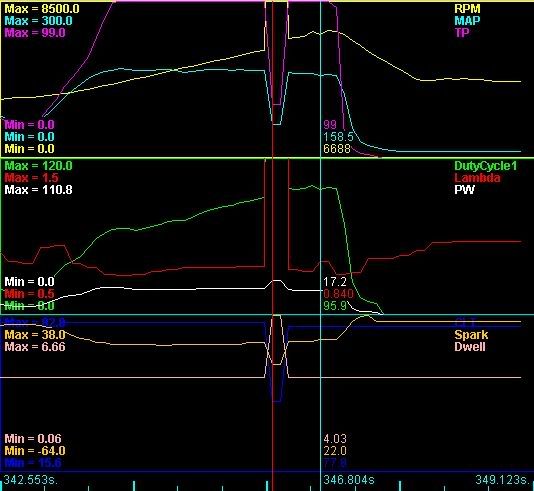

The really funky thing is that I got two ECU resets this time. One when cruising low RPM and one in the middle of a pull. You can see the one in the pull in this log (also notice the lean spike right at 6700).
Here you can see the two resets (bottom bar) and the reset from the pull.
and here is the log better scaled (was all effed up because of the resets)

Are you in disty mode or coils? Your dwell time should be as low as
possible without misfire. Have you tried setting the running dwell to something like 2.0 and see what it does? It's possible that you're overheating the ignitor.
On a side note, have you check with mark at efiexpress to see
if he's got any ideas?
YGM, just replied to your PM Chris.
Sam is right on, I'm beginning to think you might have some arcing going on between the plug wires and the head. carefully check the ends of the spark wires and look for any burn marks or pin-holes. Arcing like that wreaks havoc with electrical systems.
The wires were new from Marc a few months ago.
The car is not running with the dizzy. Its coils. I know the dwell should be as low as possible, I'm just playing with it at this point to try and diagnose whats going on. I have indeed spoken with Marc. He is the main person I have been dealing with regarding this issue. I like to post it here as well because it leaves room for a second opinion. He is thinking plug wires too FWIW.

I looked at the plug wires today and they were fine. Seems like plugs are at fault again. I was using F6DTC's recommended by Apikol :tard:
The resistored BKR7's still give problems but who knows. I'll be getting some F5whatevers and new plug wires just to be very thorough. Again, thanks to Marc. Amazing service. I'll do it nice and scientific like and do just wires, and then if that doesn't fix anything I'll add the new plugs to the mix or the other way around.

Installed new plugs today. No dice. Car died during a pull and then the next pull resulted in horribleness.
Then tried new wires along with the new plugs. Seems like problem is solved. I wont have the time to test the car out over the next week because I'll be going home for spring break and the car isn't coming with because the tire (to fix my bubbled sidewall) got sent to my billing address instead of my shipping address
Car has stupid boost leaks like usual. I'm not even going to try and track them down this time. This is why I got Hargetts. SO worth the money. I can't wait to get them on.
