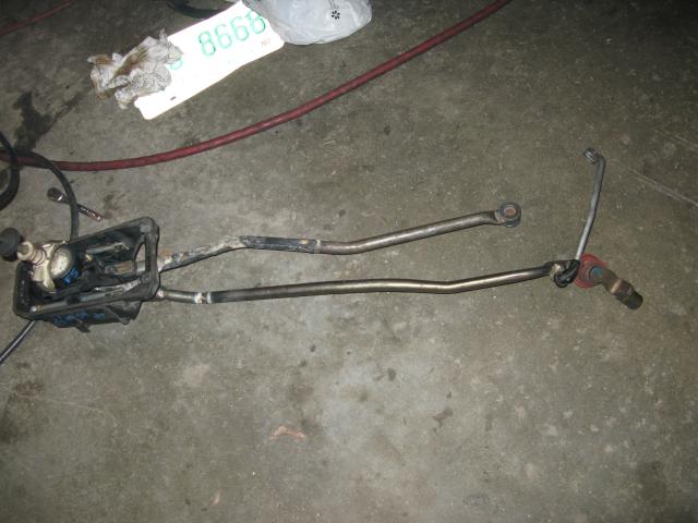

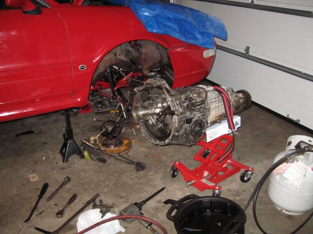

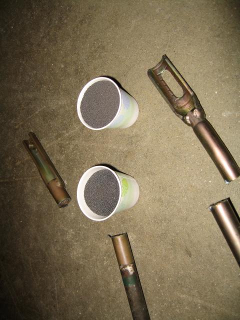

Speaking of, got back to work on the 6 speed swap. Current issue is to cut and re-weld the s4 linkage. As Janis found out on his 01E swap the rods are a little long. Pretty cool, audi fills the stock rods with lead:

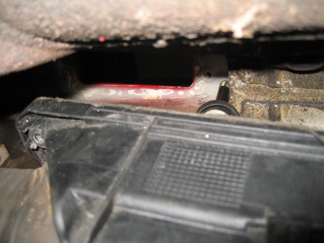

Here's a really bad shot showing roughly where the box winds up with the rods uncut:
so it definitely has to come forward several inches.
I bought a scissor style low profile tranny jack from harbor freight to make the job a little easier. It works awesome, $100 bux:

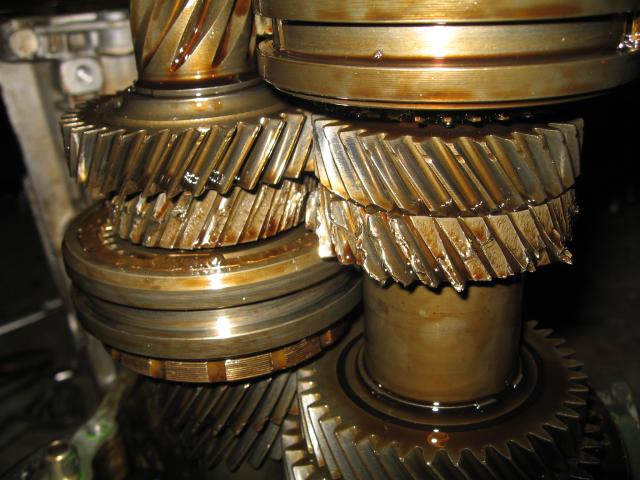

took apart the old tranny. yep, not much left of 4th gear:

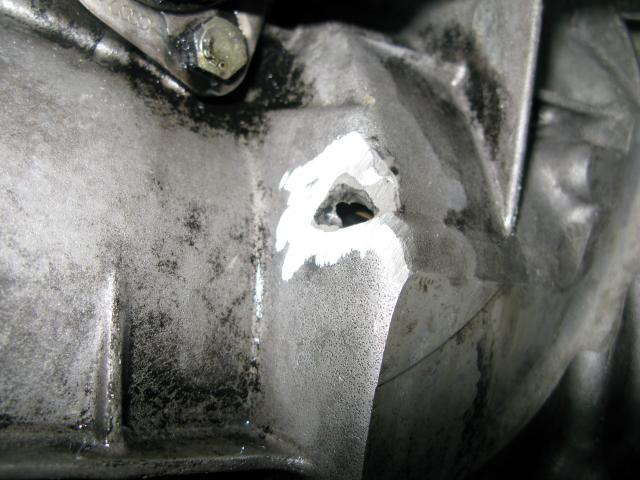

Also, while looking at my bell housing on the 01E I saw a strange wear mark, like something happened to the clutch at one point and damaged the casing. It looks like someone repaired it at one point with JB weld but it appears to be worn through. Hmmmm.

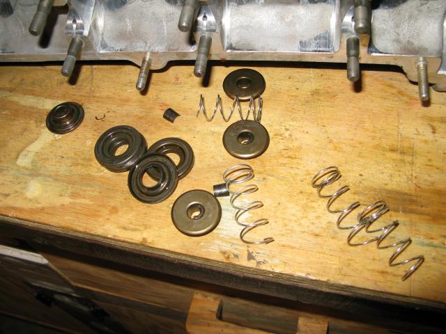

I used an arrangement of hardware store springs to keep the valves closed, only really needed one keeper jammed in there to keep things together, worked pretty damn good.

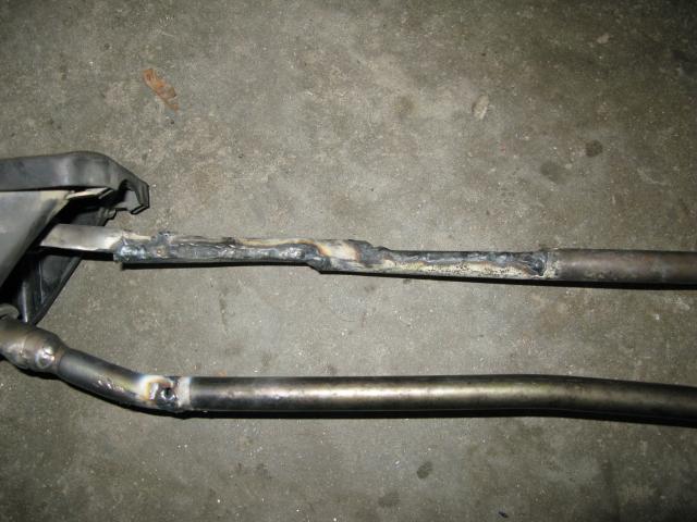

rather than beat the hell out of the body I was able to get the necessary clearance by "flat spotting" a section of the linkage:
the complete assembly:
So on that funky hole in the bell housing that I found earlier, its actually pretty big.. here it is after cleaning it out:
I'm just going to seal up the hole and hope for the best. My guess is that this is a rebuilt box and a repair was made on the case. fingers crossed..

Id just check the shift linkage every couple months and check for....whats the word...structural integrity I think its been compromised ...not saying it wont hold up but it'd suck to have it come apart while trying to go fast...at least the main gear shift portion is relatively untouched...well I'd say id trust the butt weld further as long as you got good penetration

Marc, not to be a d!ck, but man that linkage is nasty looking. Wasn't there a better way to do that? If you were one of my fab guys I'd make you redo that :P
Posts: 1589
cuatrokoop wrote:Marc, not to be a d!ck, but man that linkage is nasty looking. Wasn't there a better way to do that? If you were one of my fab guys I'd make you redo that :P
now you and Haydn both are on me about it :)
The ugly rod is merely the stabilizer, just holds the shifter in position relative to the position of the tranny, eg if for some reason the tranny shifts backwards the whole shift assembly moves backwards. Its totally structural, just looks rough.
You should have seen it when it had a 1/2" of mig snot all over it from tacking it in place from underneath the car till I got the position right ;)
