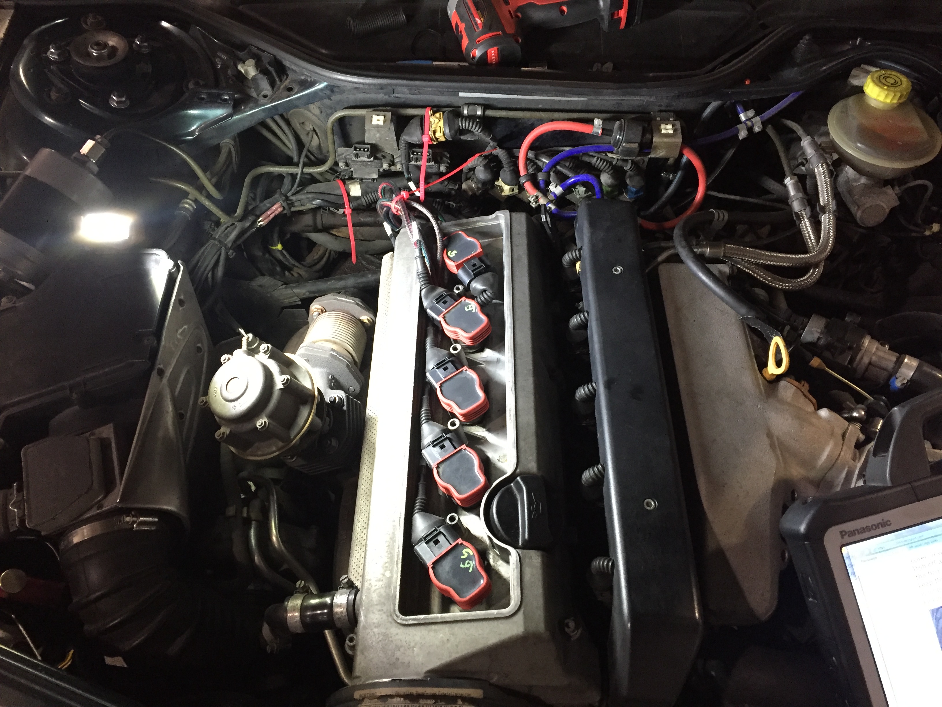

TCombs
Posts: 142
Joined: Wed Feb 08, 2017 12:04 am
Re: TCombs UrS4, Possible misfire.
Post by TCombs »
The kit installed.
1994 Audi URS4 Emerald Green
2010 Audi A5 Meteor Gray
2006 Yamaha FZ6
Looks good - nice!
