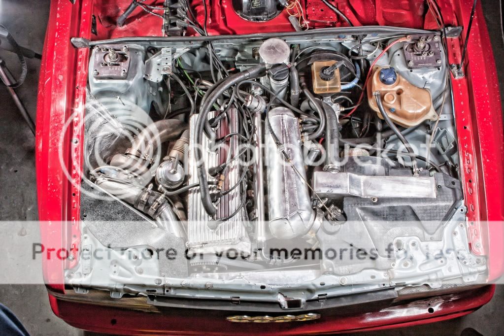

I'm running the 034 can with 1" lines going in and out, and it works fantastic. I've never overflowed it, both with the vent going to atmosphere and to the turbo inlet. Getting really big lines seemed to be the key, as well as moving it to the passenger side of the engine bay.

Did you route your lines(s) behind the engine, then? Also, what does being on the passenger side have to do with it? I think I'm just going to upsize my line and have nice, easy radius routing. Going to atmosphere, do you use the little filter and that's it? Or do you... point it somewhere? lol, TDI elephant hose style?

If the can is on the pass side, the oil which pukes out of the CCV has to fight to loop around to the opposite side into the OCC.chaloux wrote:Did you route your lines(s) behind the engine, then? Also, what does being on the passenger side have to do with it? I think I'm just going to upsize my line and have nice, easy radius routing. Going to atmosphere, do you use the little filter and that's it? Or do you... point it somewhere? lol, TDI elephant hose style?

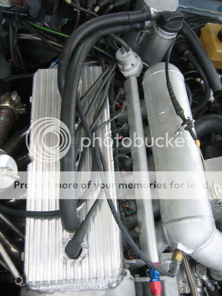

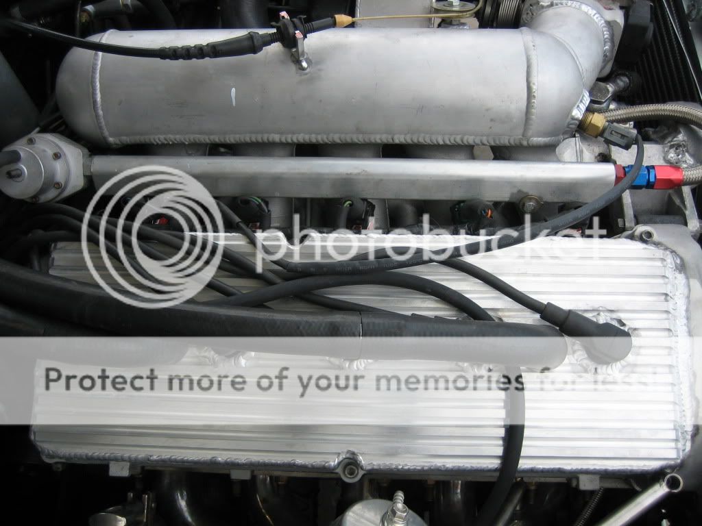

So I took it down and used it as a jig to make some manifolds for some friends and customers. I have made 3 of them now for my car, and then people want them, and I end up selling them... Besides not having an IM, I was tired of my breather to relieve crank pressure as well. I did not have the can draining back to the crank, so I was consuming a ton of oil, and if it got too high, it overflowed everywhere. I was not sure I was getting a good vent either, as I was pulling off the rear of the VC, and I think that it was sloshing into my can..

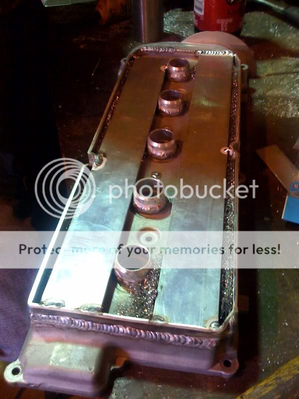

So I went to the drawing boards and decided to make my own valve cover that would seperate 99 percent of the oil, and then I would just have it going into a can to get the remainder. I started with a 7a cover, built up the sides about an inch with plate 6061, lathed extenders for the spark plug holes and deleted the oil fill up location. I then noted carefully where all the oil was sloshing from(mostly the cam lobes) and drilled 1/4" holes where that was not taking place. I put about 40 of them in there. I then put stainless steel wool over the holes and put covers over them to provide yet one more baffle, and trap door the oil had to overcome to even get to the open space where i was pulling a vent off of..
I then found this sweet surplus piece of 6061 extrusion that I wanted to use, so I made the top, and welded in provisions for two 3/4" vents. I used pushlock hose to get from the cover to the can, and I am for now just putting the remainder into the air filter so I dont have to smell it inside the cabin.

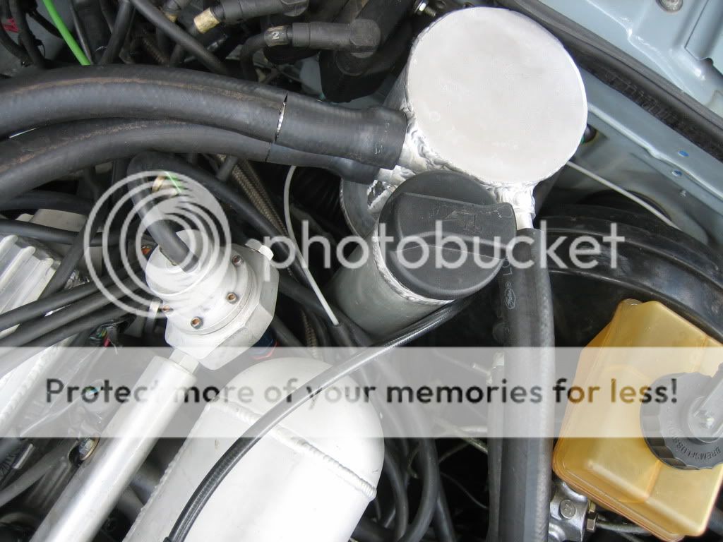

This setup has been working well for me. You need a really big catch can if you are going to use the crank vent.
http://www.motorgeek.com/v/audifreakjim ... e126a45c98
It vents just down by the subframe, I never smell crankcase fumes. The tip of the hose has a little residue on it, but to be expected after 40,000 miles.

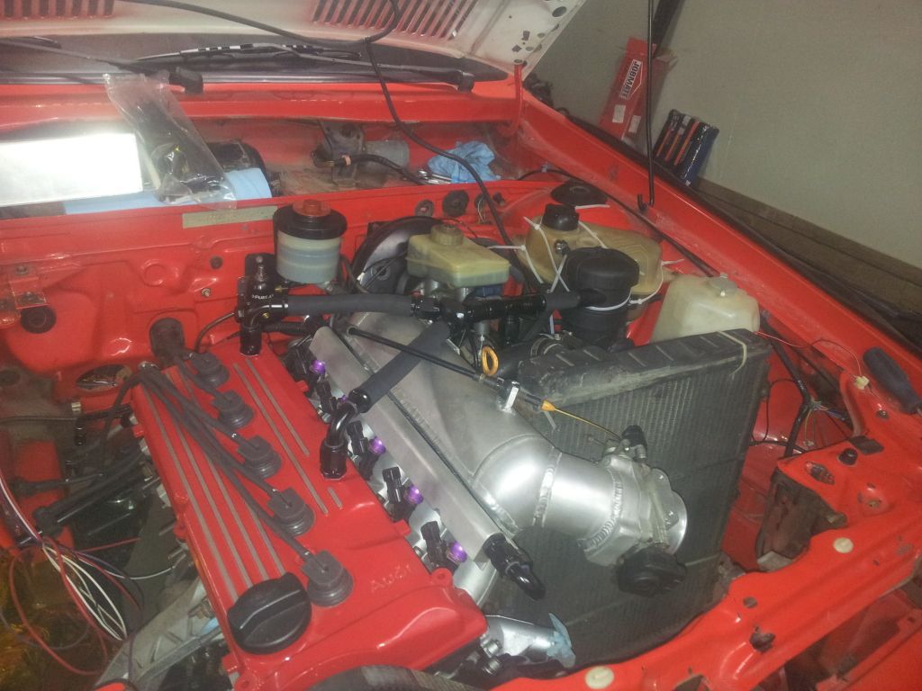

Very interesting stuff. I ran two -10 lines from the valve cover that tee into a line from the crankcase, then off to the catch can. That will then go from cc to the intake(haven't finished yet because I haven't finished the air filter setup yet). Now I'm second guessing myself and wondering if this will be enough. I would like to drain the cc back to the pan but didn't tap the pan while it was off so I'll probably get it running and drain it into a bottle and see how much oil it pulls first.

That's nice. I need to remove and re-paint my VC anyway, perhaps I'll do something like this. But bigger... lol. Or at least one big one at the front. Did you do anthing else to the valve cover?
Re: Darin's 80tq...484whp...
No I just tapped it for the fittings and stuffed in some steel wool. The fittings are directly over the cams but between the lobes. I am hoping that the 90 degree bends and the steel wool can throw some of the oil back into the head but time will tell I guess.

It will still be far less oil coming out of the head like that vs using the oil pump hole on the side of the block.
