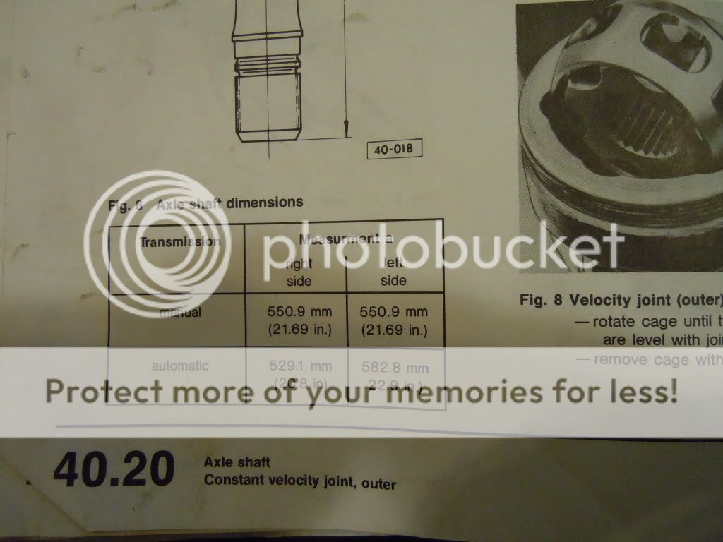

Okay, a bit more information pulled from manuals for information.. Here is the data from the 4000/coupegt/quattro manual indexing the different shaft lengths..
Here is the data from the 5000 manual. The 5000 never came in an AWD automatic configuration, so I assume that the two options are for 016 trannies and then auto FWD. The 016 lengths between the FWD and AWD must be the same.
I did stop by the junk yard, and the inners on the 5000 FWD Auto's are indeed 108mm inners, and the outers apear to be the same splines as the URQ/4kq hubs..
Unfortunatly, it looks like the track of hte 5kq was wider, and so this info in only useful for the type 44 guys wanting to do 01e swaps.

I'd think it would increase since when you jack a car up, the tires usually slide inwards.
Re: Hanks 81 URQ the death of a 016, and a nail in the coffi
Nice Martin. It appears that two Passenger fronts, or two fronts and one rear drivers shaft will fit the bill. Where those measurements with the wheel off the ground, or on the ground? The shortest the shaft will be is at the ground with the wheels straight. The longest with the suspension extended, and turned to full lock(like around a corner with the inside wheel lifting). If you can compress the suspension to ride height and not have the shaft bind and then have it released and get full lock without bind, you are golden.
