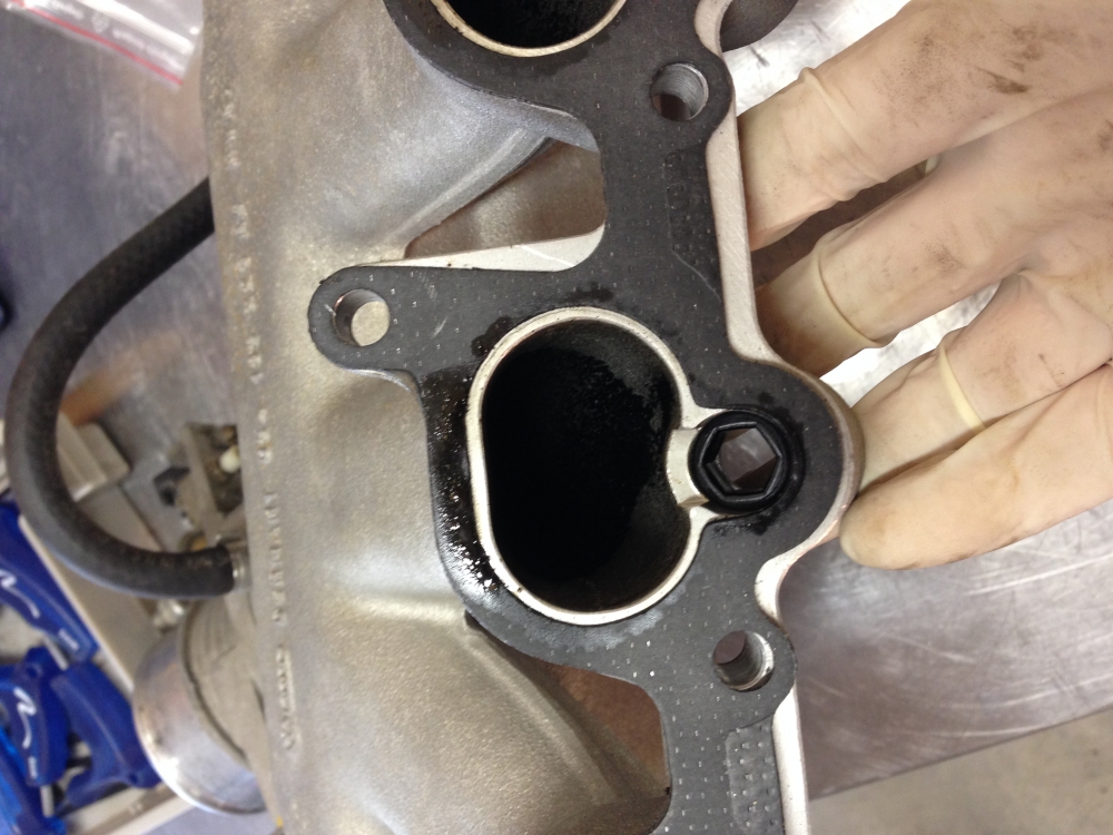

Up here at 9000 ft. 'ol Hungry needs to breathe a little easier. I gots some Hank bits to put in there(still waiting on the IM, which should be coming soon) and started to pull the old stuff out. A couple of things that struck me as odd were when I pulled the stock IM off, I noticed some oil on all of the runners, some of which were worse than others.
Would incorrect valve timing cause this? I'm running a catch can vented to atmosphere and the intake plumbing to the throttle body is dry as a bone so that rules out the turbo and PCV system. The motor is using oil, which will be handled hopefully sooner than later, which I was thinking might assist in this, but what do you guys think?
Another thing was that all of the EM studs came out with the nuts, except the two seen in the picture. Is that normal or were the studs not tight enough in the head? I've read that they aren't supposed to be tight, only just snugged in. Those copper nuts really put a bite on those studs!
