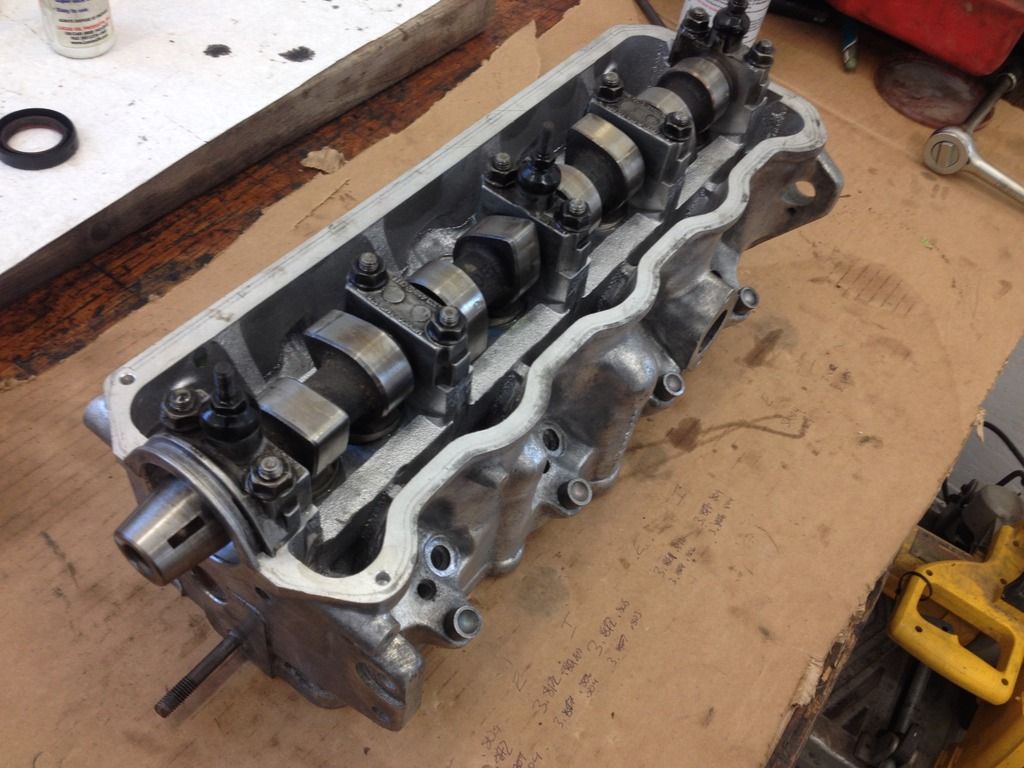

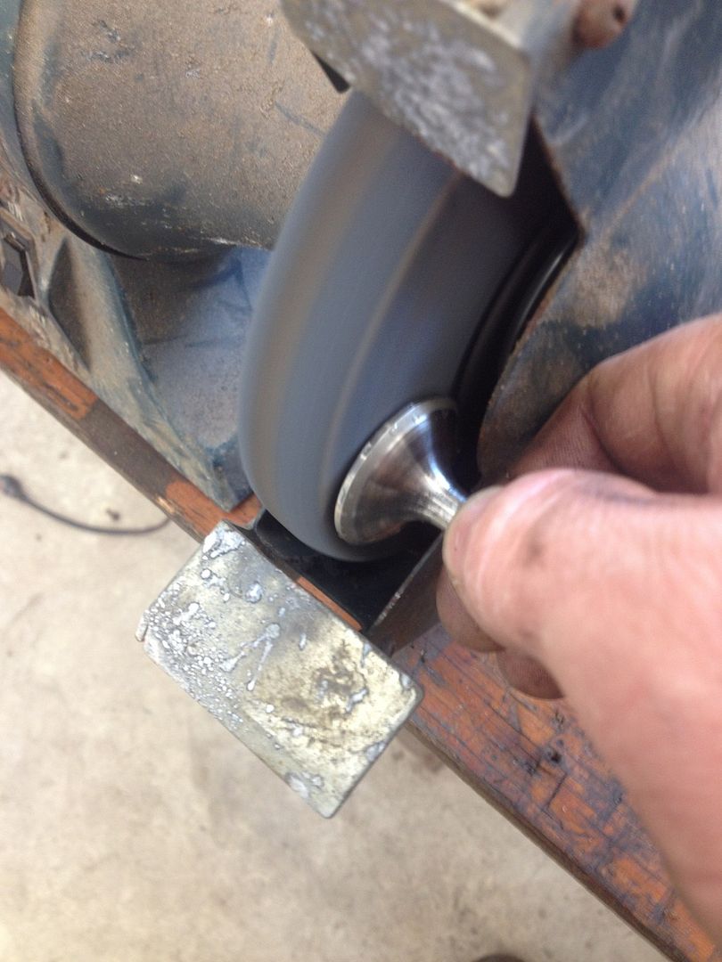

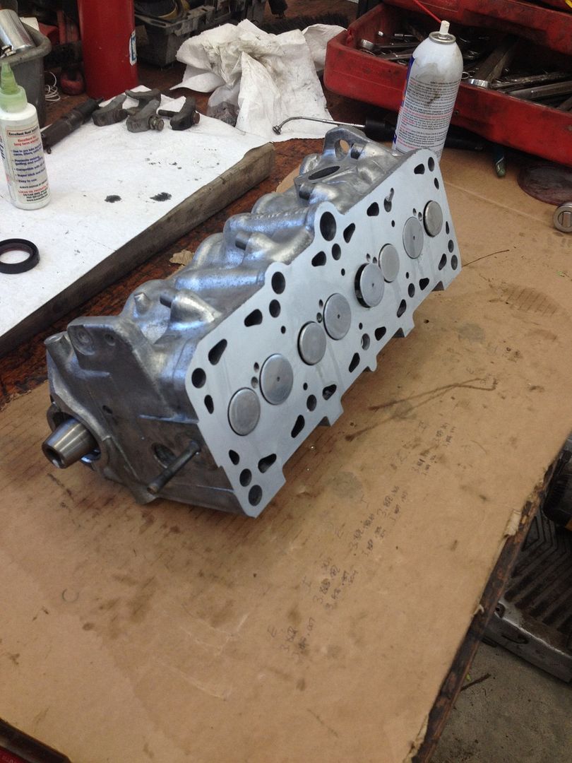

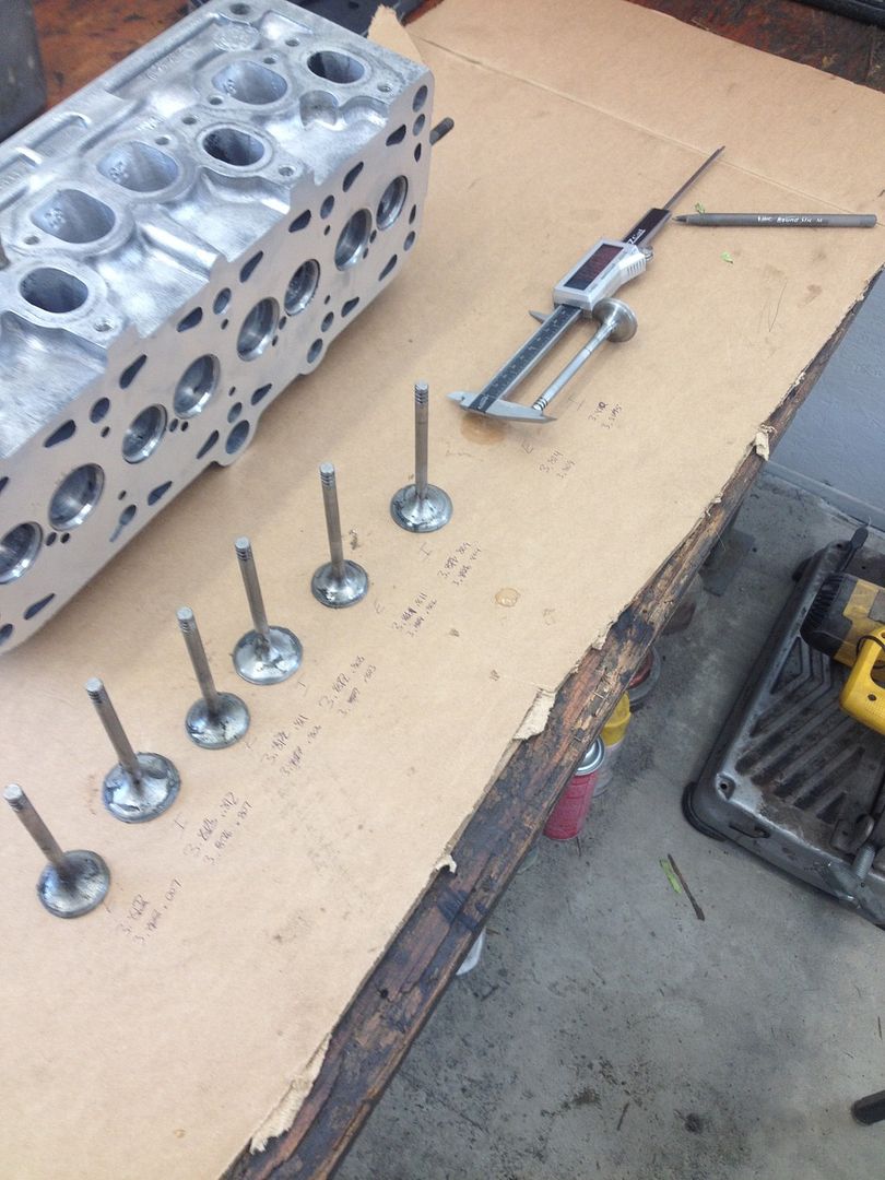

Because I'm a diesel newb, I had the head decked to ensure flatness. They only took off 5 thou, but in hindsight, it was probably not necessary. Since diesels have such tight piston-valve clearances, I realized that I new had shaved off .005" of the .015" clearance that the factory had the valve to piston clearance. I got creative and decided to carefully measure the valve length and shave the ends off on a bench grinder.
I then spun the valves in a drill and polished them down on a straight edge with various grades of sandpaper. They are nice and smooth and are back to the factory clearances. Time will tell if this explodes, but I think not.

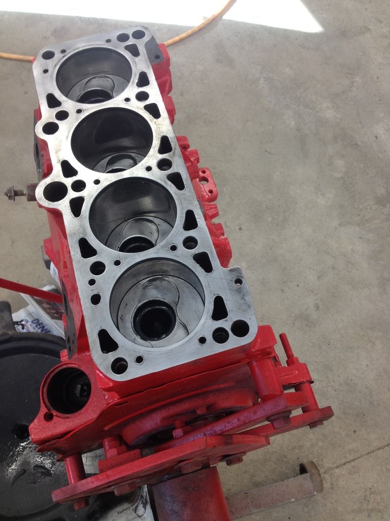

head all re-assembled.

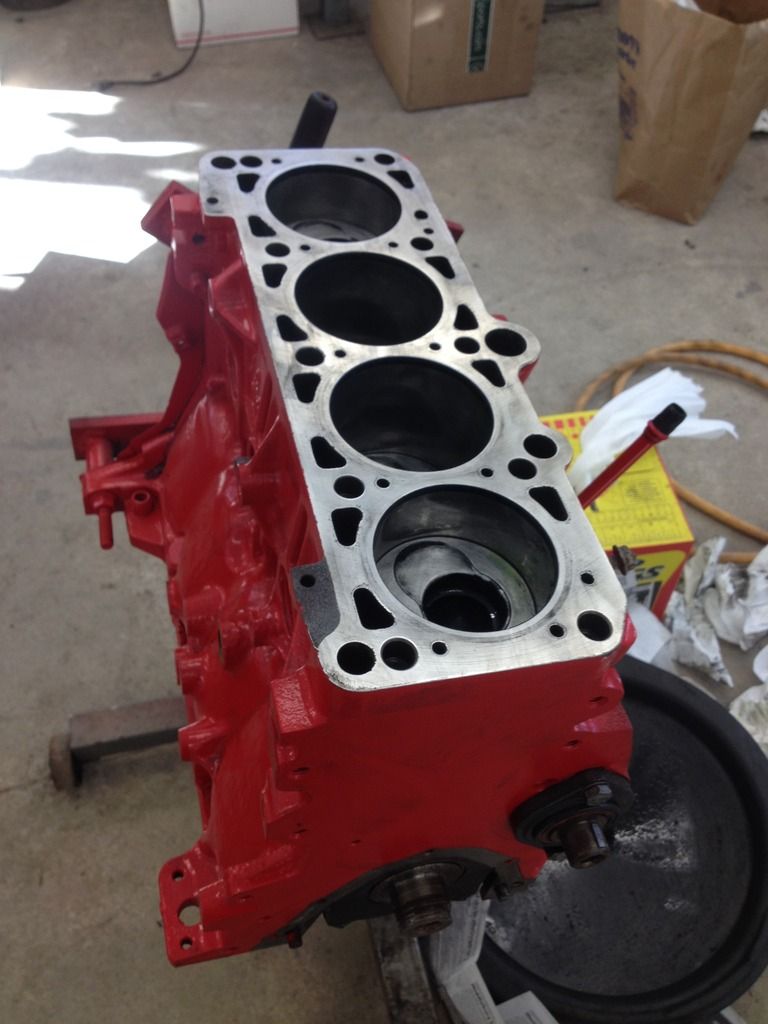

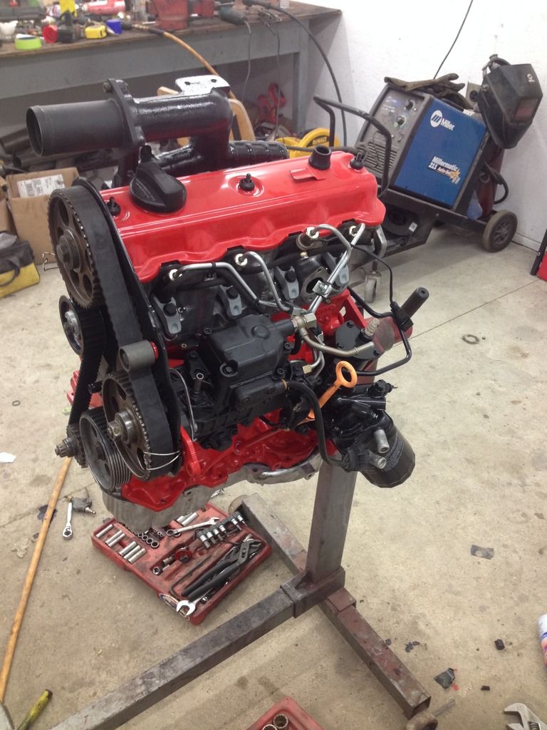

spend a bunch of time cleaning, scraping, needle scaling, sandblasting (every bolt) and painting engine parts.

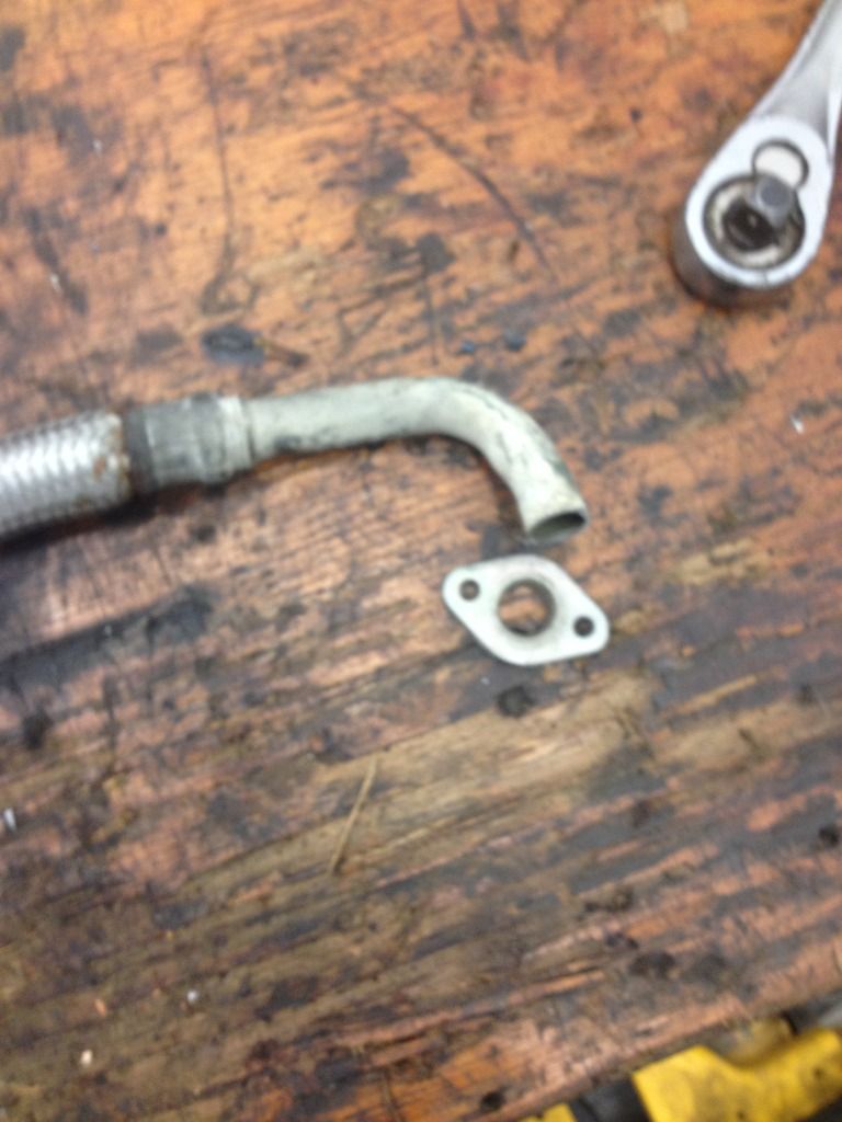

Then I made a little block off plate for the 1.8t turbo drain. The tdi drains back into the block, so i didnt need this port. I used an old drain from a 1.8t and cut off the flange and plugged the hole.
new timing components. There was an ungodly amount of veggie oil fossils everywhere here from a leaking injection pump main shaft seal.

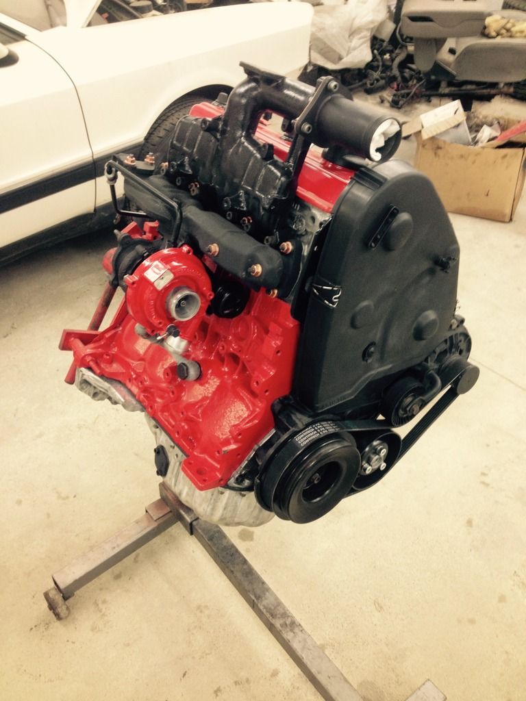

coming together

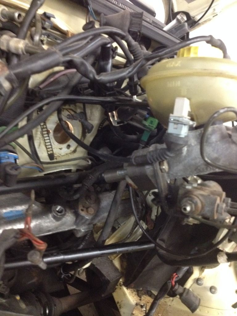

did a little work in the engine bay before putting the engine back in (hopefully for good this time)

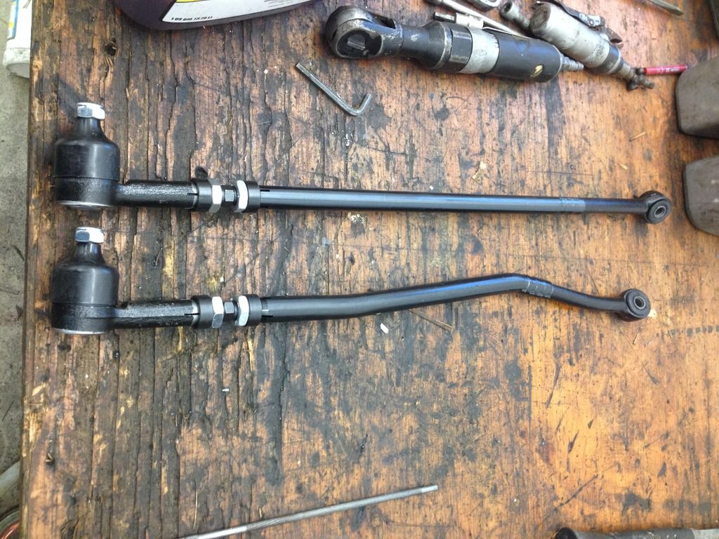

new tie rods for the car

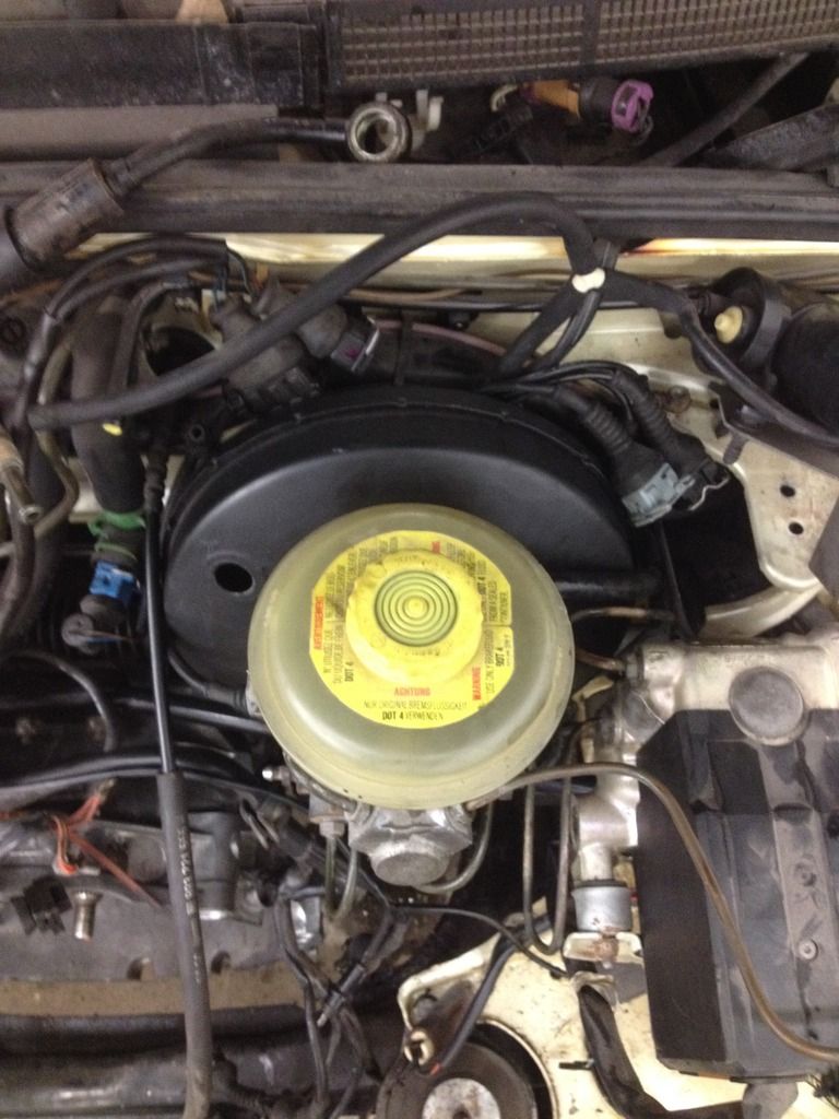

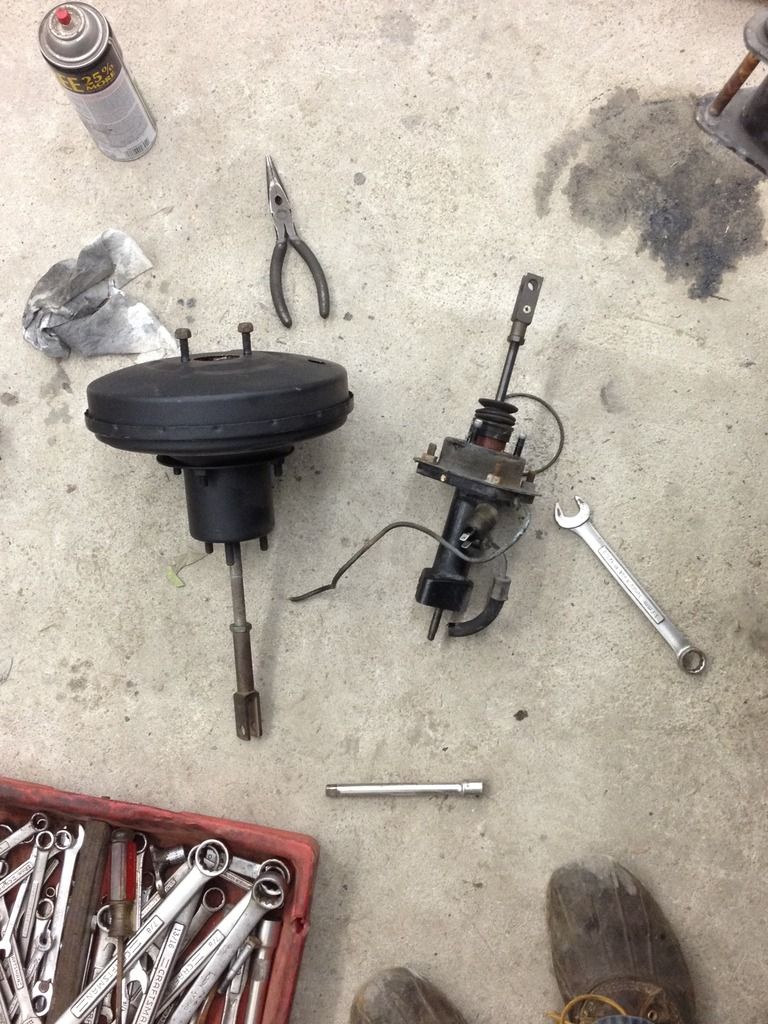

vacuum brake conversion

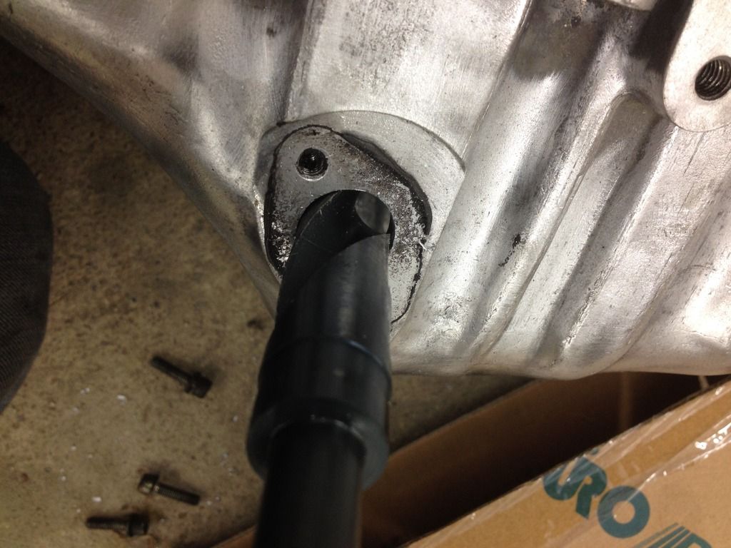

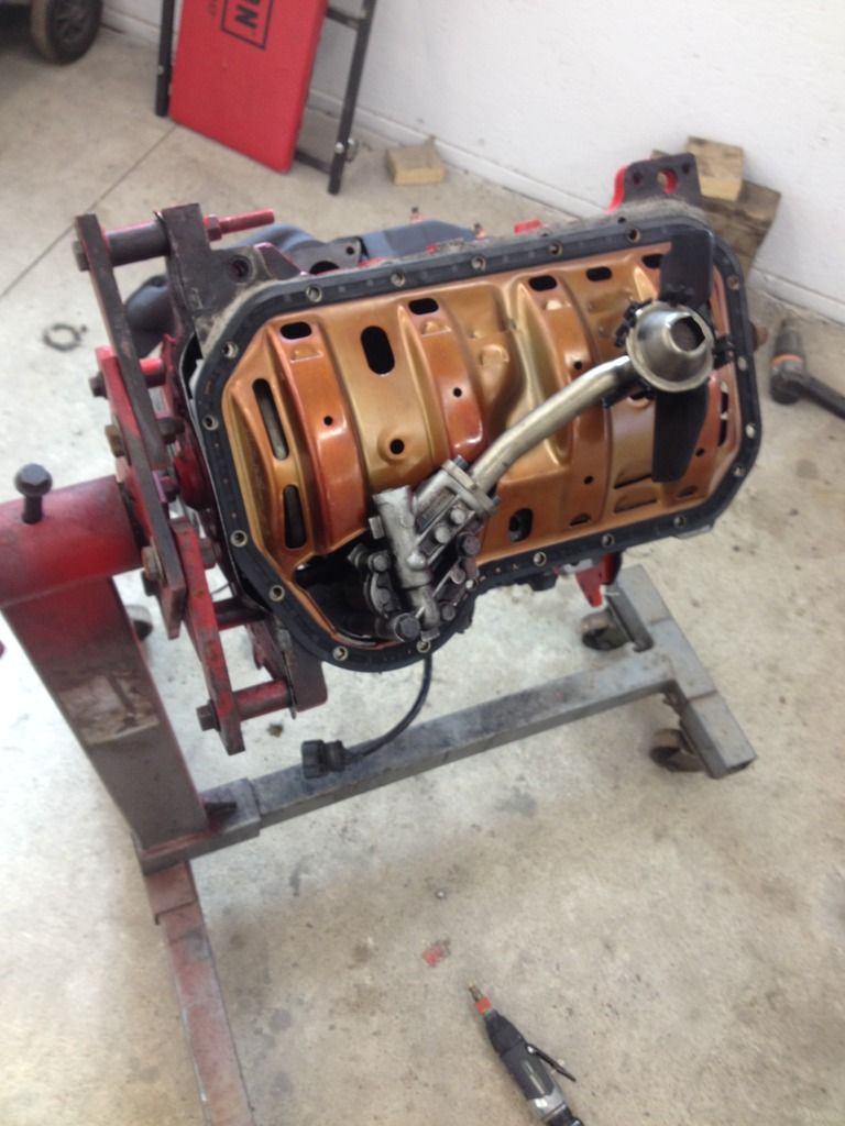

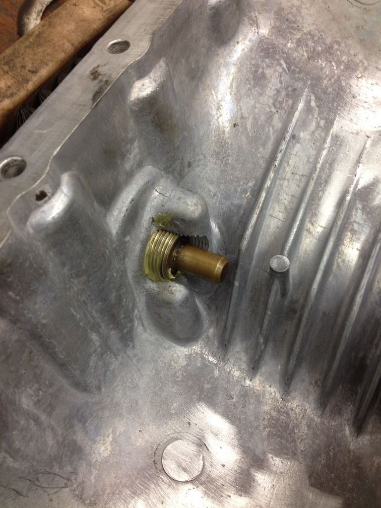

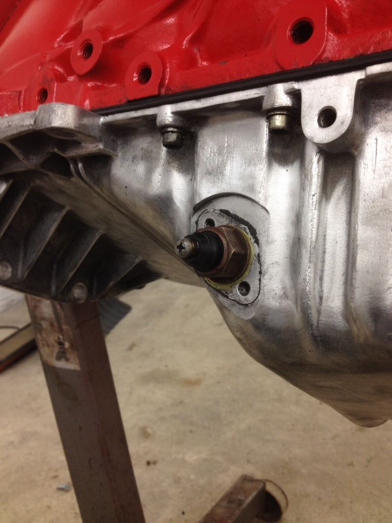

then i decided i wanted a working factory oil temp gauge, so i removed my cap on the oil drain in the 1.8t pan and tapped it for the audi factory oil temp sensor.

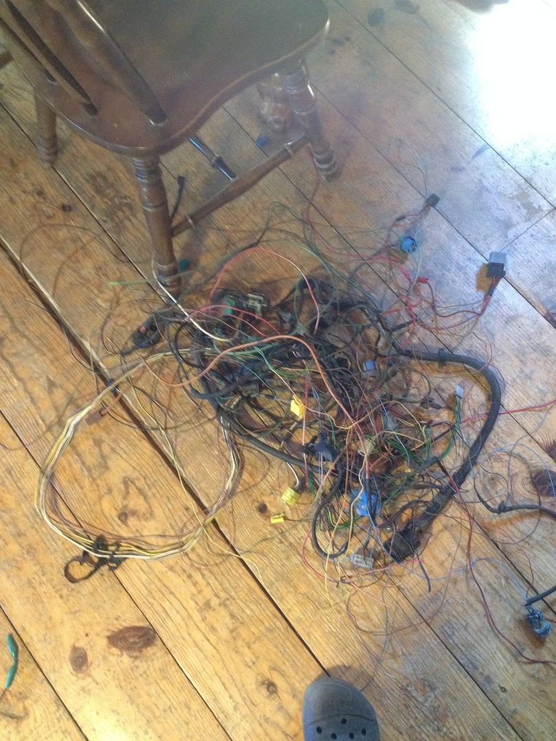

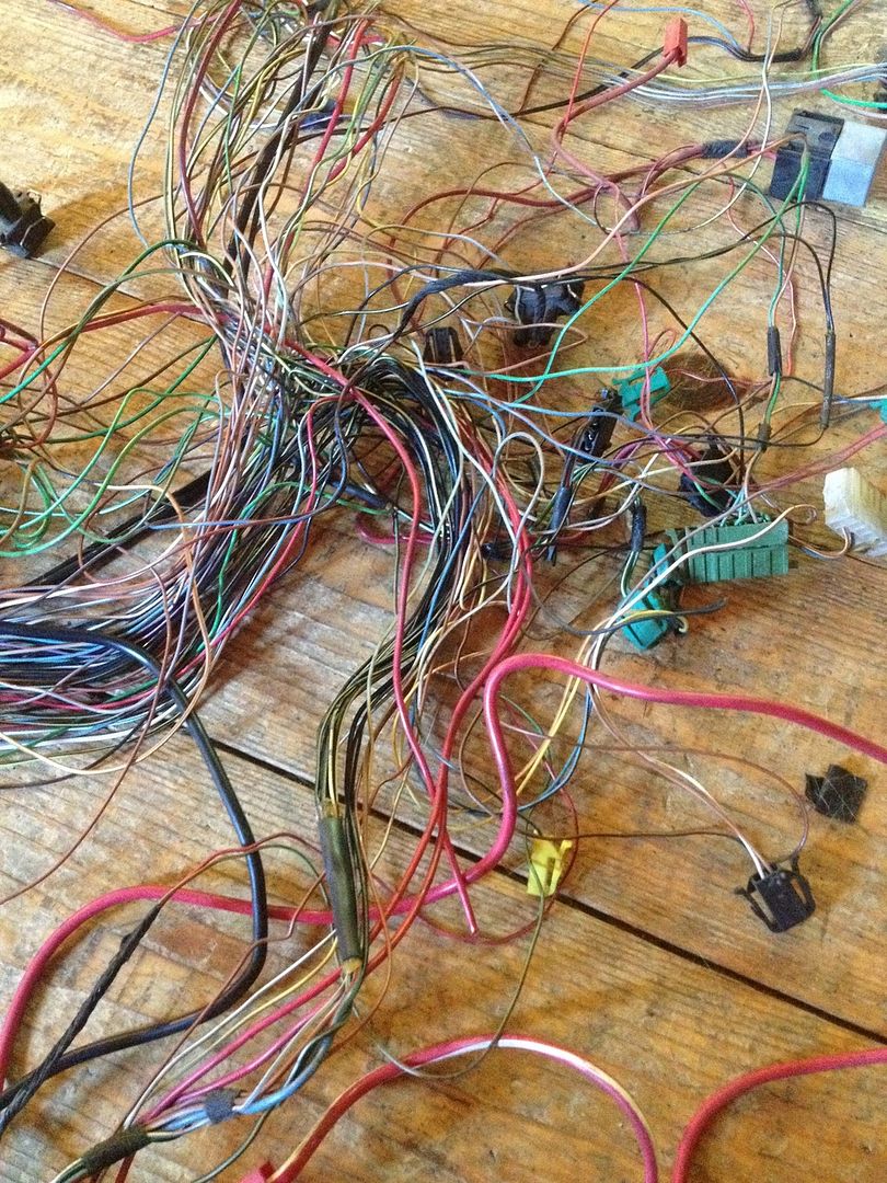

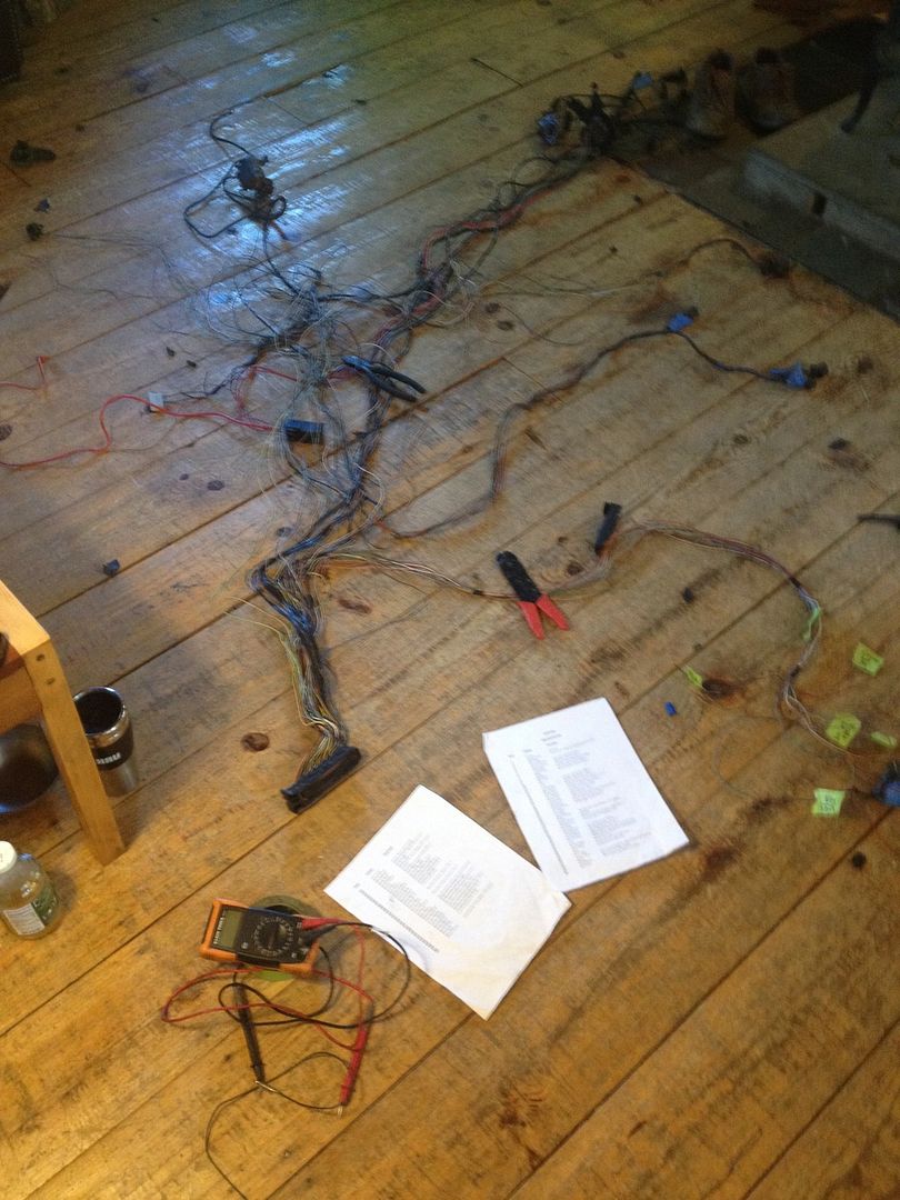

spend a good 6 hours on the floor learning the wiring harness.
hell hole

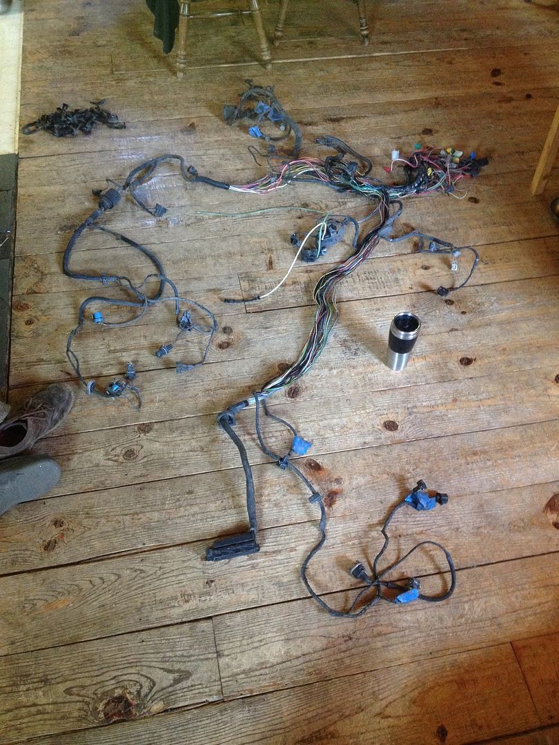

getting it pared down
eliminated wiring

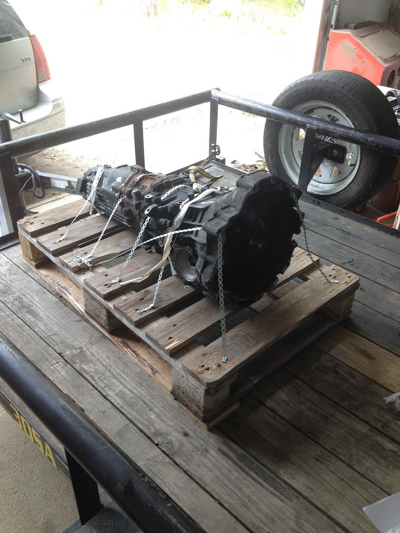

purchased a tdi 01e 4.11 6 speed quattro trans, this will make the whole project worth it. It became apparently to me after driving around my mk4 in 4th gear that I would need something with TDI gearing to make this swap worth the effort and money.
coming together

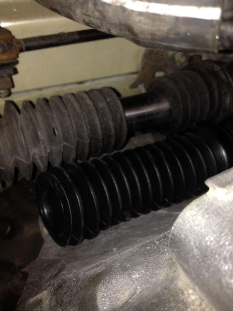

new rack boot
hell hole
eliminated wiring
