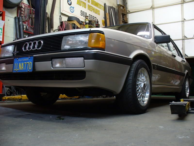

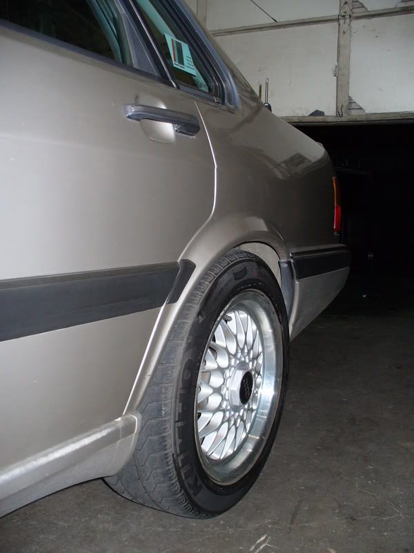

yay! one of my best friends works at a dealership and decent set of used kumho's came in... in 205/55/15. so i picked the best BBS rims i had and sent them off with him sunday, and got them back today :D they fit really well and look great!
i polished the rims lips up a bit and then wiped the tires down with some dressing as they were a bit dry and old looking. they'll work fine until they wear completely out and i have more $$ for new tires :P

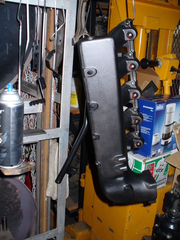

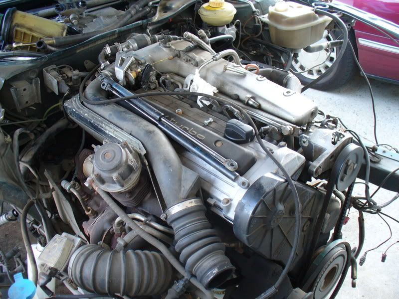

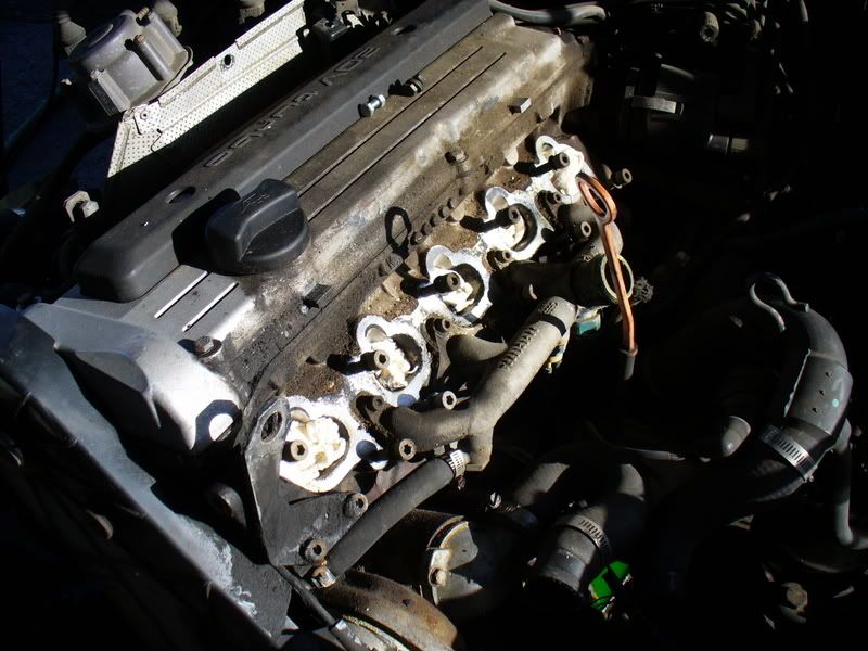

i've also been slowly picking stuff off the donor engine and getting it ready to pull. it's all unbolted, i'm just waiting to get a free engine stand for the clean up i need to do to it. some before pics...
and i got the intake and a bunch of odd parts cleaned and ready for some paint :)

Post by derracuda »
Audilard wrote:What are injector bung plugs? Can you get those somewhere?
what bungs? :P
In the picture of the 3b intake manifold hanging down there are red/clear plugs in the injector bungs. What are those things?
derracuda
Post by derracuda »
oh, those are just plugs so i didn't get paint in there and have injector sealing issues ;)
