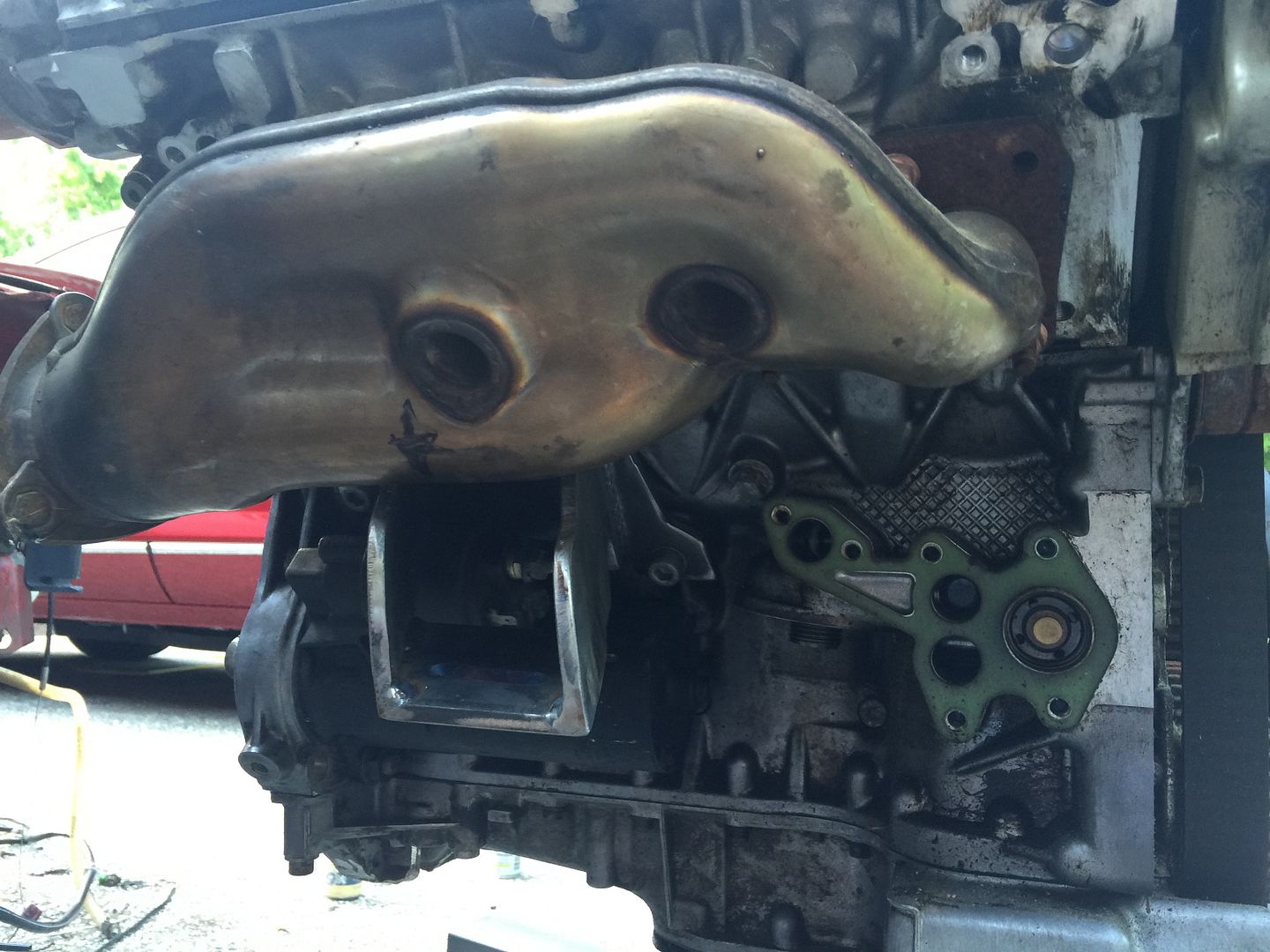

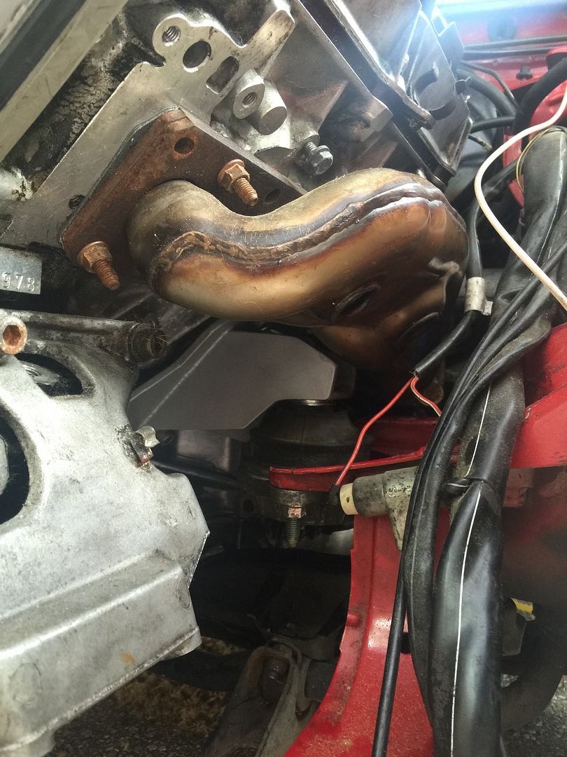

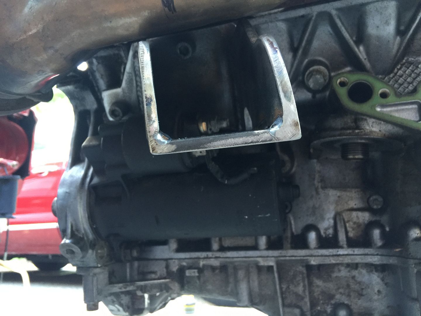

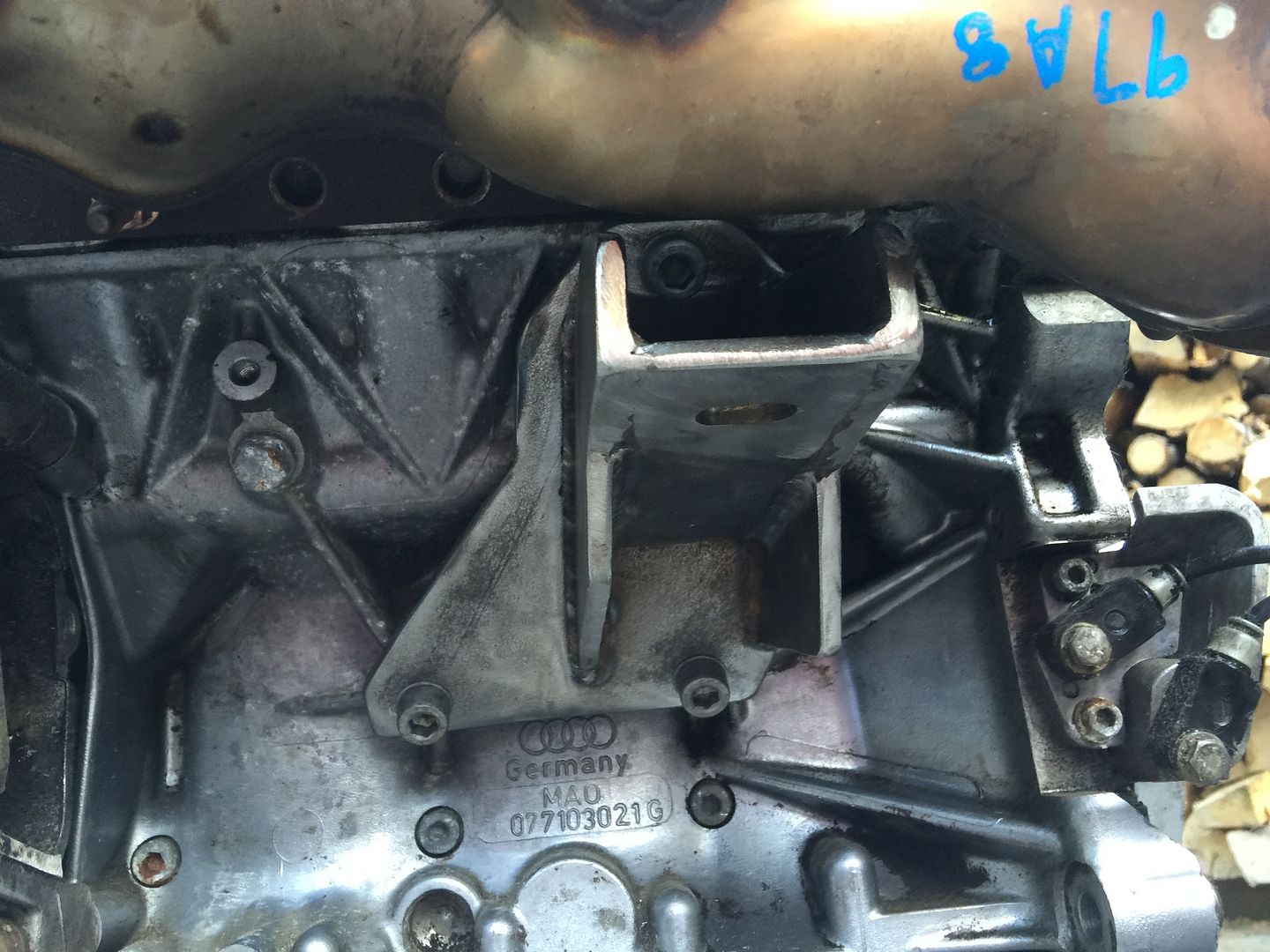

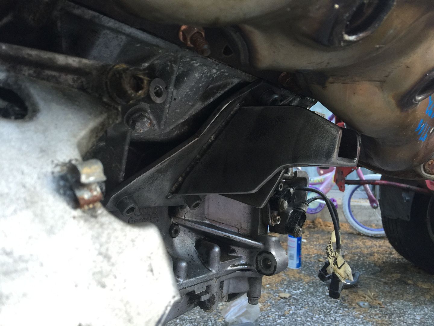

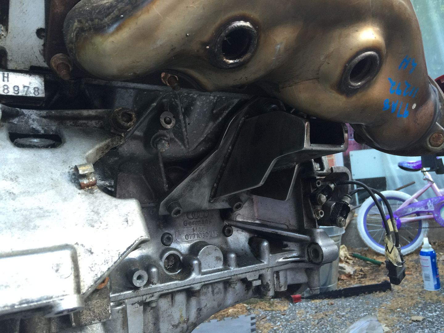

Here are the motor mounts finally after 4 months...
This is all pre-paint
The Drivers Side is perfect - everything lines up perfectly
the passenger's side is good but not perfect. the arm hits the motor mount too low so I will likely hang the mount down from the frame.
Now I can finally install the clutch, engine harness and start buttoning the mother up!

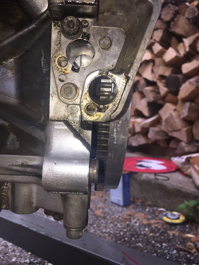

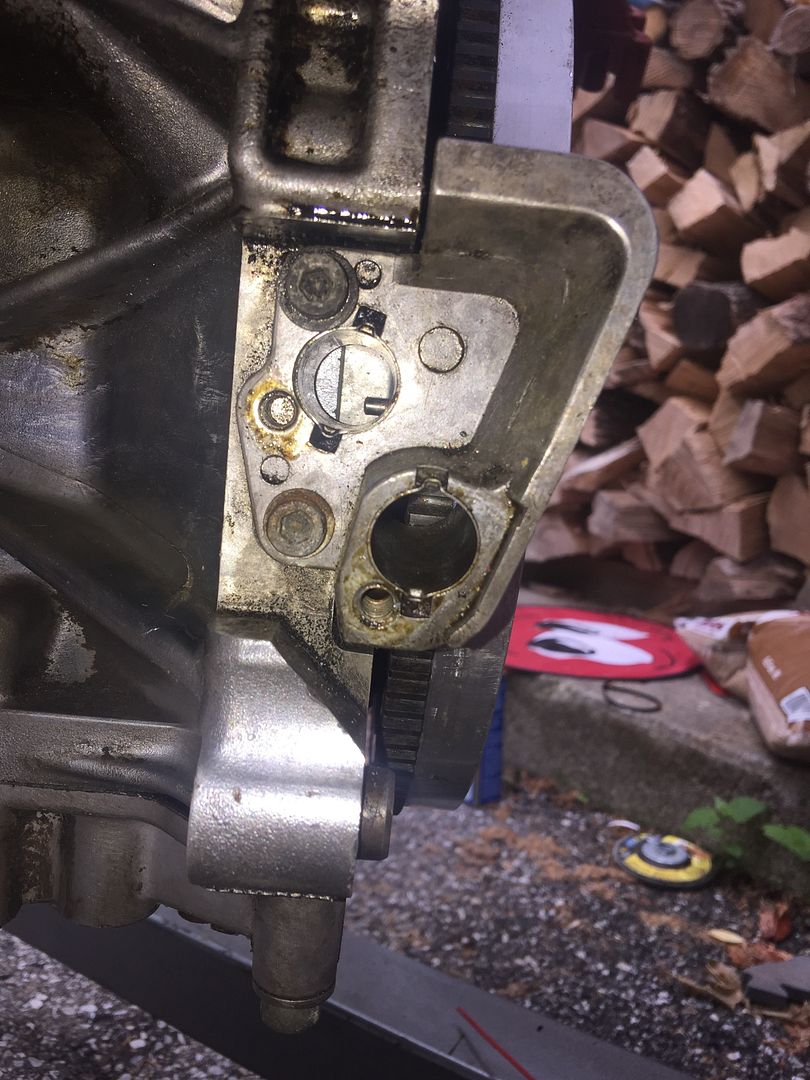

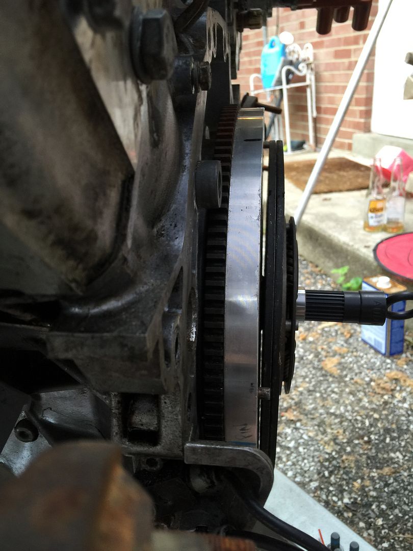

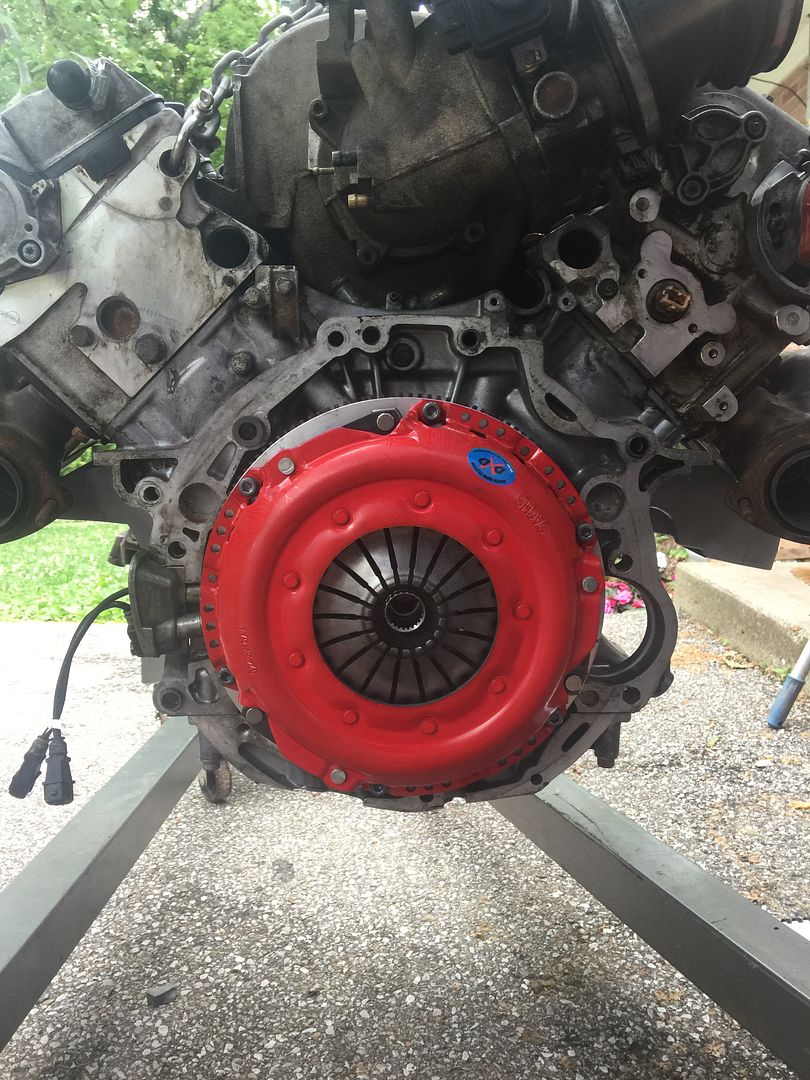

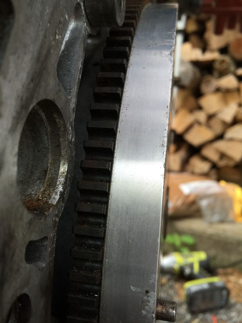

a bunch more progress today. I was hoping to get the engine in for good so I can start building things around it. Until now I've had it with the flywheel attached but no clutch or pressure plate. This kept it so the engine was easy to take in and out for fitting (which I've done 40 or 50 times)

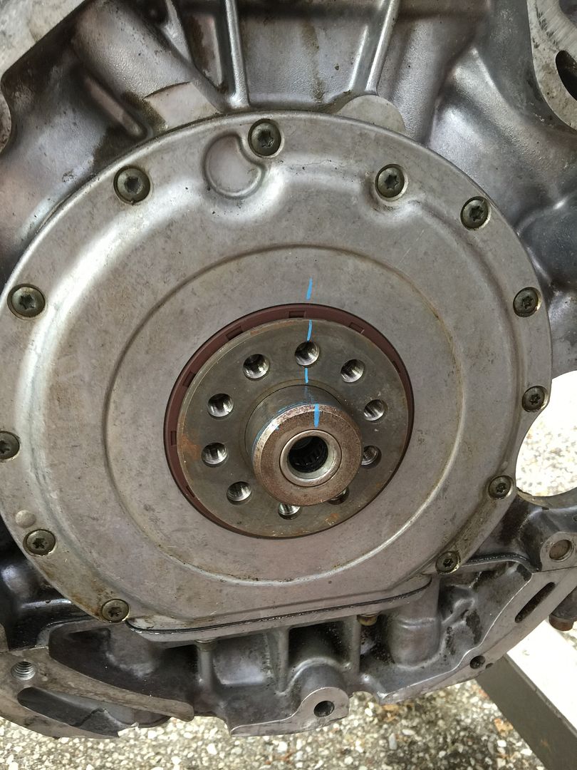

So today after priming, painting and attaching the mounts, I went to put the pressure plate and clutch in.
I was having some trouble though as the 034 bushing was sitting just proud of the flywheel. see below...
it was creating a gap between the clutch and the flywheel that would not work
So I remember there was a spacer behind the pressure plate on the ABH originally so I put that behind the flywheel to push it out a little bit and it solved the issue. I considered grinding it down a few mm but didn't want to do any harm.
It did push the starter ring and crank position sensor out from the sensors a little bit though - that is a concern...

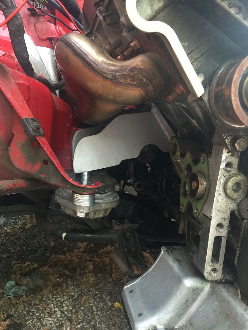

With that done, I put the engine and transmission together, and monkeyed with the engine mounts to get the height of the engine correct and keep it off the subframe.
Note the washers lowering the motor mount on the passenger's side.

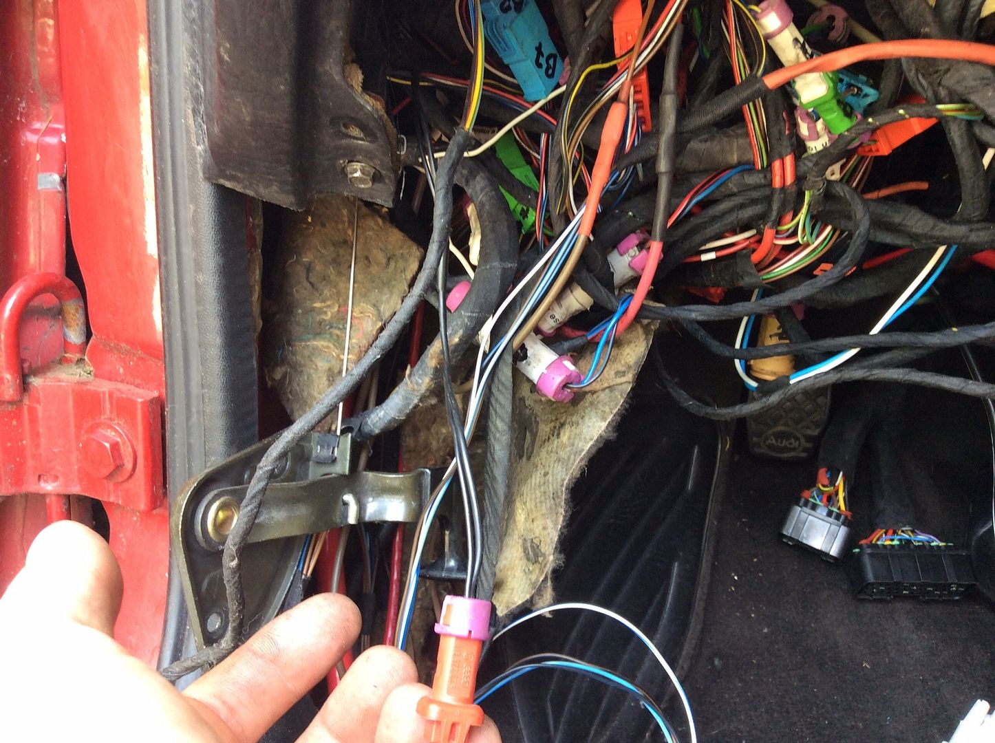

Made more progress over the weekend...

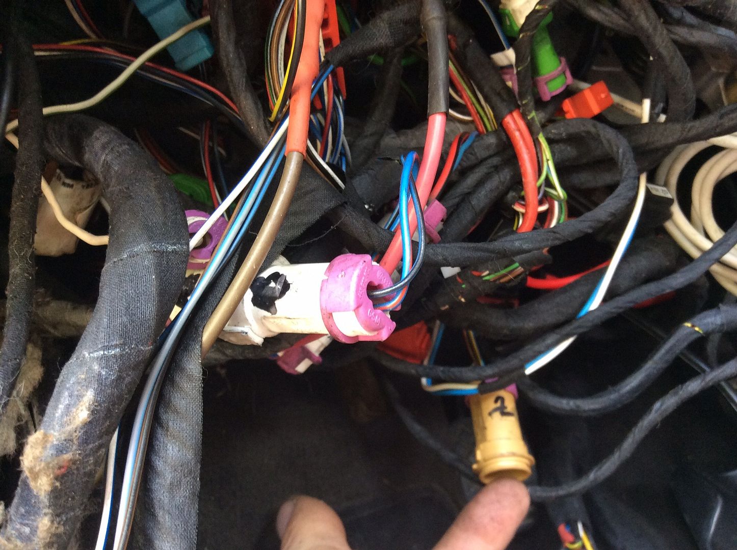

Put all the wiring back into the car and attempted to reconnect everything. Only a few plugs are still loose.
Got the dash back in (and did the heater core / flap recovering while I had the car apart)
put the carpet back in though without any floor padding it fits really loose.

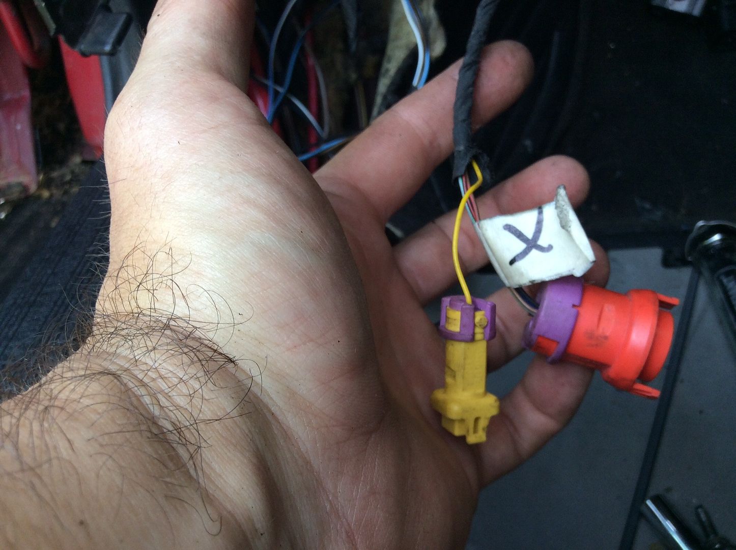

Here's what's left unwired...

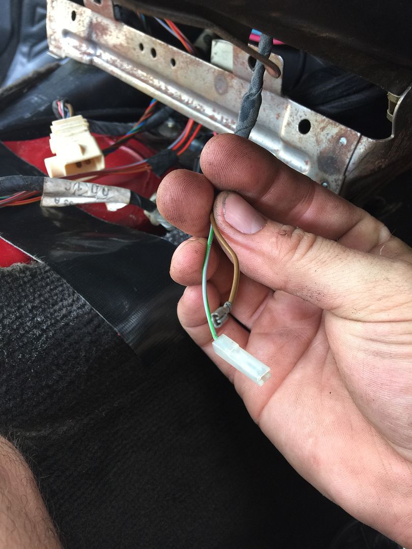

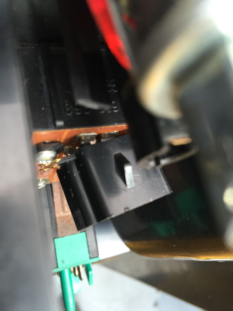

Found the diff lock display and button broken:
But got a bunch of stuff back together.

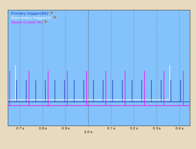

I pulled the plugs and turned it over to see if the triggers are working right. they appear to be - right?
Then I put the plugs back, installed the coils and plugged in injectors to see what would happen...

your trigger log has spark events. so, no spark probably means power or ground supply problems to your coils. you can use "test mode" on the ignition outputs visual page to fire the coils manually for testing purposes. one click = one spark on the test button.

I am troubleshooting now and as far as I can tell I have ground at the coil connectors, have constant 12v there too. I am NOT getting any signal at the POS's though. I should be getting 5v from the ECU outputs correct?
Also, I now don't get the trigger log showing up. I sometimes get no data when I try to log it.

I get a ground pulse when I test on the coils! and some voltage that's so fast my multimeter can't measure it at the POS's
I would say the Ignition is set up correctly!
I think I have trigger issues now. I was able to get just the primary trigger to show up again but not all of them.

Even weirder, I get a good triggerlog result without the plugs in but with them in I have issues

Okay, super weird.
I put a 12v LED in one of the injector plugs so I can see it pulse - if it's pulsing then I know the injectors should be firing - which can't happen without triggers.
I get good trigger readings and see pulsing with all the spark plugs out - so I start to put plugs in to see when it stops working.
as soon as I put a plug in either of the front two cylinders (1 or 5) I lose my triggers.
I can put all the plugs in cylinders 2,3,4,6,7,8 without any issue. In fact, with those 6 cylinders hooked up I can start the car (though really sketchily)
https://youtu.be/7zm63OkJCuE
I'm trying to figure out what could possibly cause this?

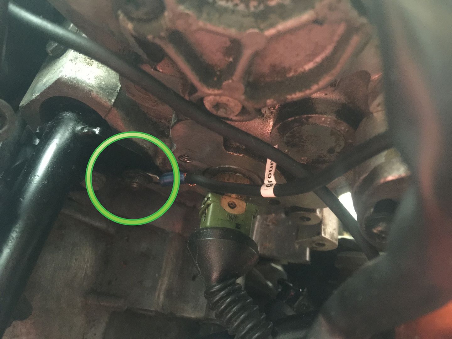

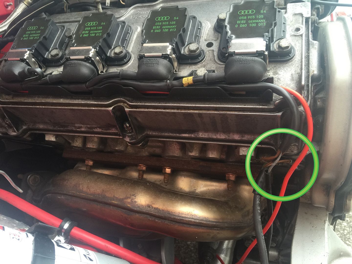

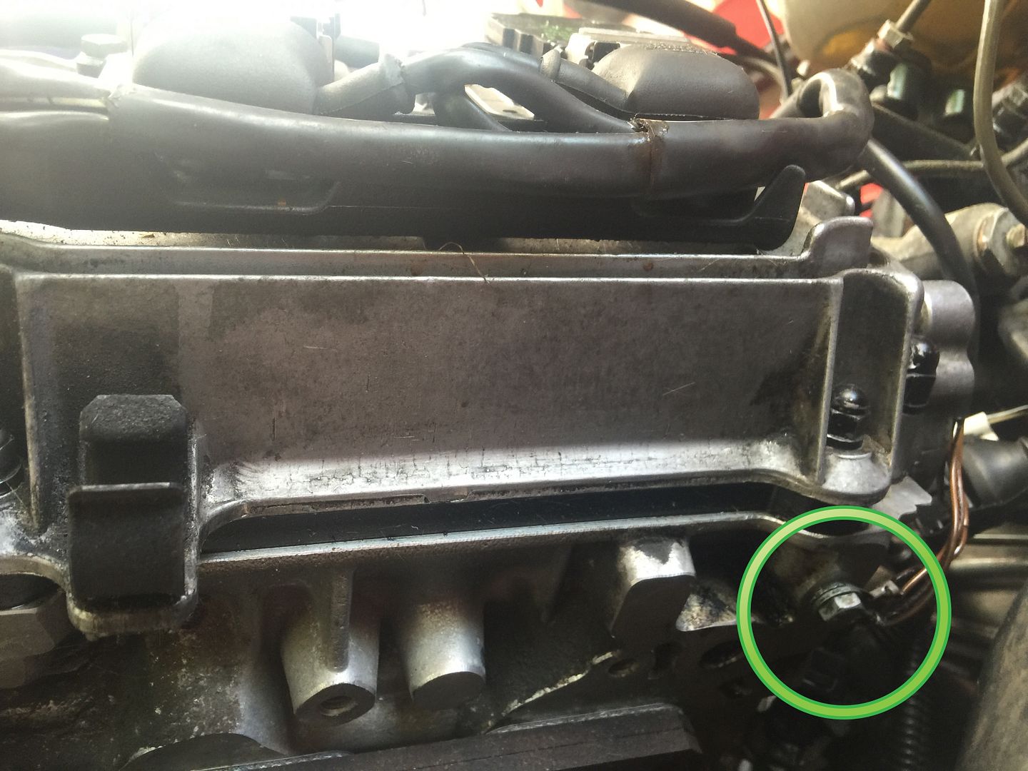

ignition noise most likely. lets talk about your grounds. how is each ground connected in your harness, and how do the stock coils ground? specifically to what locations.
Grillage
Posts: 863
Location: Cincinnati, OH
Re: Ben's V8 Coupe Quattro - First Start preparations!
Post by Grillage »
the sensor Ground and common ground bundle all goes to the rear passenger's side of the head. I used the stud that holds the hard coolant pipe in place on that side. I'm going to doublecheck some things this morning to make sure all is correct.
As for the Coils grounds, I am using the stock harness - I'll trace down which of the grounds from the stock harness carries that Coil ground and report back.
Also, I don't think I was super clear on the issue. The first triggerlog above was done with all plugs out, coils disconnected and injectors disconnected. I was able to get the same result with plugs out, coils connected (but hanging off obviously) and injectors plugged in.
However, If I put a spark plug in the holes of Cyl 1 or 5 (not the coil - just the plug) I lose my triggers. the only thing I can think of is that this would create some continuity between the head and cover that is otherwise not there. so weird!

Ground from ECU
Ground from Coils
passenger side:
driver side:

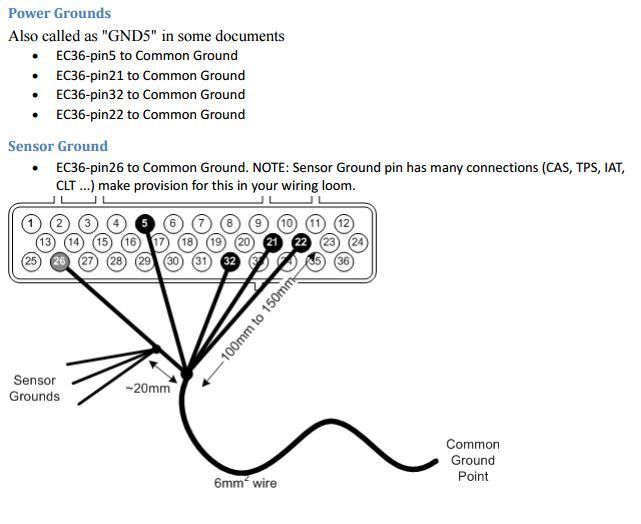

I did it per this drawing...
