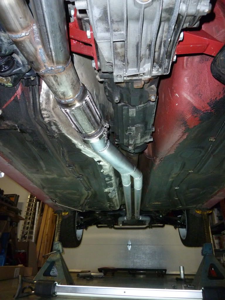

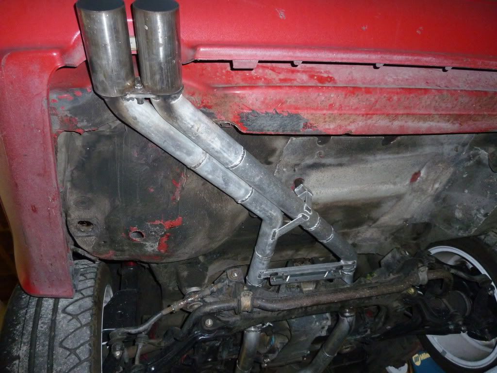

Sounds like I may go spintech. I'm not gonna go with headers since someday i may go turbo so they would be a waster for now. my exhaust is dual 2.25 aluminum so what i'm thinking is where the exhaust comes out the back side of the subframe on both sides of the diff i will angle them to the passenger side and merge them into a single 3" pipe that goes to the muffler and then just 3" out of the muffler over the the exhaust cutout in the bumper.
heres a pic of what it currently looks like...

Nice setup. 2.25" is good sizing for that displacement. What is max rpm on those? My 360ci spins max at 5600 rpm currently, at least until I put a new valve train and cam in.
Personally, I would lose the single pipe, throw in a balance pipe as close to the manifolds as possible, and keep it a true dual. Spintechs flow well enough to where you could keep your current setuo and run a single in, dual out

But that piping looks very well done. Ill have to snap a few shots of the truck. If you turbo that, you will have to open that up to at least 2.5" - 2.75" depending on how much turbo you run. But yeah headers arent great for turbos. Vacuum = bad on turboed cars. Although if its a single turbo, run a header on 1 side. Or, run headers and an sts style turbo setup

I think there was a fitment issues on the driver side and thats why the driver side down pipe crosses under the trans and goes into a single pipe. Cant recall why exactly, but also I was told that audi v8s sound funny with true dual exhaust. If i go turbo it will all get completely changed. remote turbo would be cool. Oh, i spin it to 7k rpm.

Damn. Even now I know you would gain a good amount opening that up to 2.5"

About my exhaust, I dont think going with 2.5" would net me anything at the moment. its only 4.2 liters and the exhaust is only restricted by an insert. No cats, mufflers, or resonators, so its pretty much straight through. With some boost its a no brainer that the exhaust would be somewhat of a restriction. Thats pretty far down the road though.
