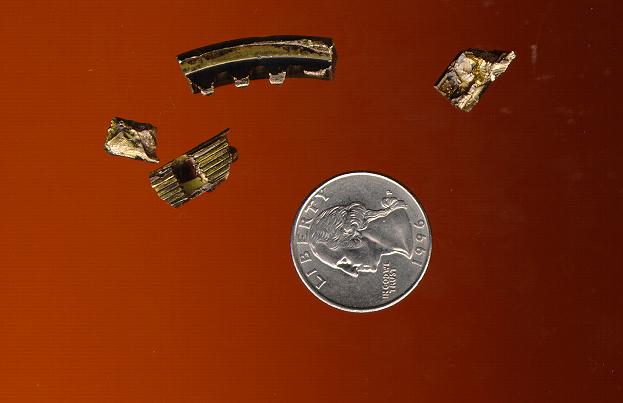

Myke, reminds me of driving my 88 90q for about 3 months with a badly grinding third gear. Eventually on the way back from my GF's house the car stuck in fifth gear and wouldn't come out! Lemme tell ya, driving home was.. _interesting_. I could smell my clutch the whole way home!
here's the fun stuff that come out of the drain plug when I got home. You could even read the part number off the chunk, yep, 3rd gear syncro ;)
Your story beats mine :-P

Holy crap, no wonder your tranny blew, any other change come out of it??! :P
