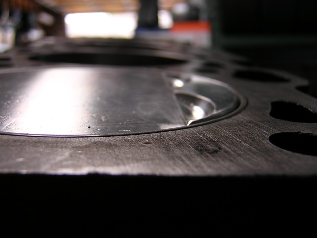

Here's some pics of the pistons.
Attachment ( 2768 ) : P1010094.JPG
Attachment ( 2767 ) : P1010092.JPG
Attachment ( 2766 ) : P1010089.JPG

Interesting skirt shape on the sides there!

Hey Jimmy, interesting pistons, check out my pistons, here is what I did (or how my pistons turned out):
The dish on your Weisco's looks really big, you sure its 13cc's? Also, the valve reliefs are really big, any reason for it?

I noticed that on Jim's Wiseco's that the sharp edge between the valve pocket and the edge of the piston has been removed, whereas on Javad's JE's, it's there. There were some reports on the S2Forum that this thin "edge" can become a hot spot, potentially causing detonation, and in some, it even melted. Those that have gotten JE's since, have ground away this sharp area.
Any thoughts? Javad?

Well can't be much different than these areas!!
Attachment ( 2770 ) : P10100891.jpg

The dish on your Wiseco's looks really big, you sure its 13cc's? Also, the valve reliefs are really big, any reason for it?
Yea, that's why I sent you that email. It looks like on your pistons they just shaved it off and didn't really dish it? These maintain the compression hieght all the way around, which would cause the dish to look bigger in the middle.
It looks like that's what they've done to me.
I might try and get some clay to see what these actually are. before these go to the machine shop tomorrow.

They look really nice. I noticed the piston looks like it does maintain the compression height all the way around. This should help with detonation on pump gas. They look like quality pieces. Let us know if you do cc them.

Well, just taking the major diameter of the dish and not figuring in the fairly significant camfer in the dish at 7cm and .35 cm deep would give 13.5 cc's. I'm not sure if the valve reliefs are included in the calcs or not, but it looks good to me.

I wouldn't call these areas "sharp" on my pistons, they are dimensioned exactly like the stock pistons, the areas are quite rounded over and I don't anticipate any hotspots becuase of the valve relief areas. I haven't seen Jim's pistons up close so I can't comment on those.
Yea, Jim, must be a visual illusion from the pics, and the large ring land rise makes up the difference.
And for referece to others that have mentioned it, the 20vt head's only quench area is right above or adjacent to the intake valves, or basically the "unmachined" area or "raised portion" on my pistons, the rest of the combustion chamber is completely open to the piston and simply makes up the hemispherical combustion chamber.

with the stock mc bore the material gets pretty thin, (i have cut mine down a bit on my mc pistons for my 7a/mc combo) with an 83 mm bore like javads it would be fine. imho.........worse case, the problem would fix itself :P

RSCoupe wrote:I noticed that on Jim's Wiseco's that the sharp edge between the valve pocket and the edge of the piston has been removed, whereas on Javad's JE's, it's there. There were some reports on the S2Forum that this thin "edge" can become a hot spot, potentially causing detonation, and in some, it even melted. Those that have gotten JE's since, have ground away this sharp area.
My new JE's are scheduled to arrive Wednesday.
Thanks Javad! :-)
i don't know if you guys have looked at the pistons after running.but i had the same thing on my bbc weisco pistons,i like javad,rounded them over because from the factory they were sharp.when sharp,they melted away and disappeared down to a certain level.the rounded ones stayed put.neither engine had a detonation problem.engines are still running strong and haven't been pulled apart for 2 yrs of beating on the water.
