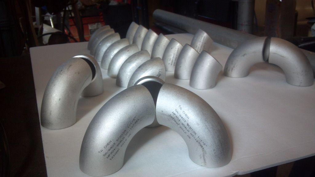

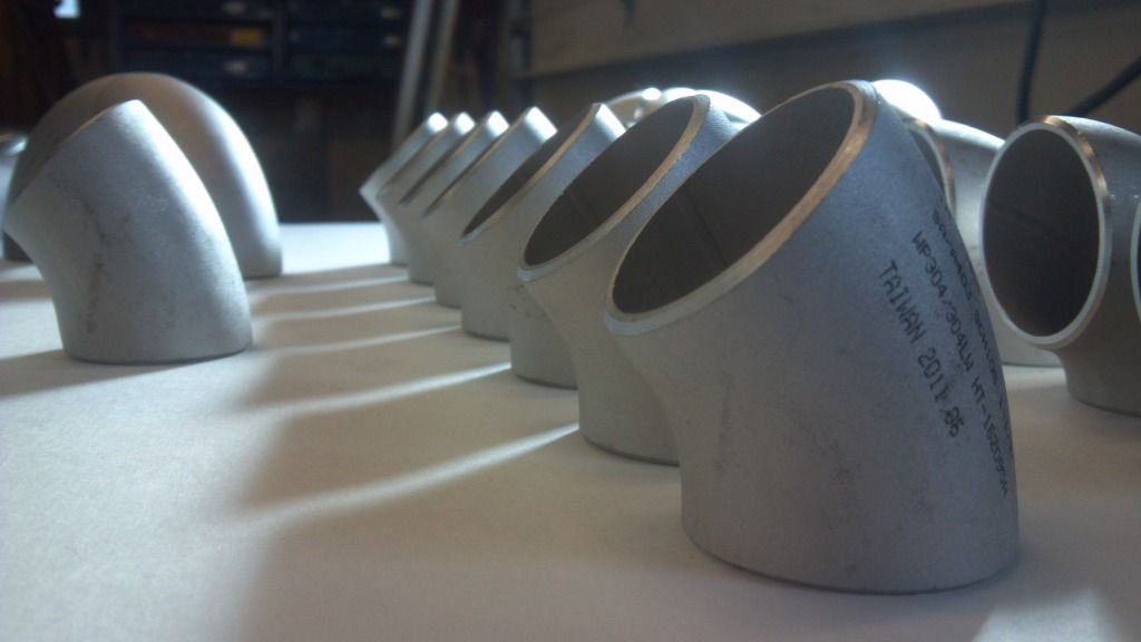

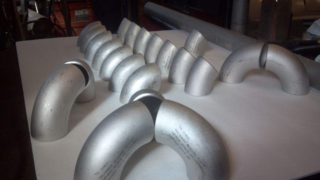

Postby glibobbo21 » Thu Mar 14, 2013 3:19 pm

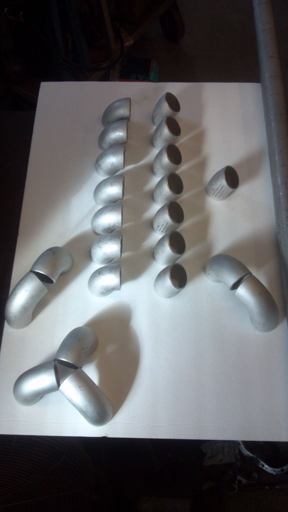

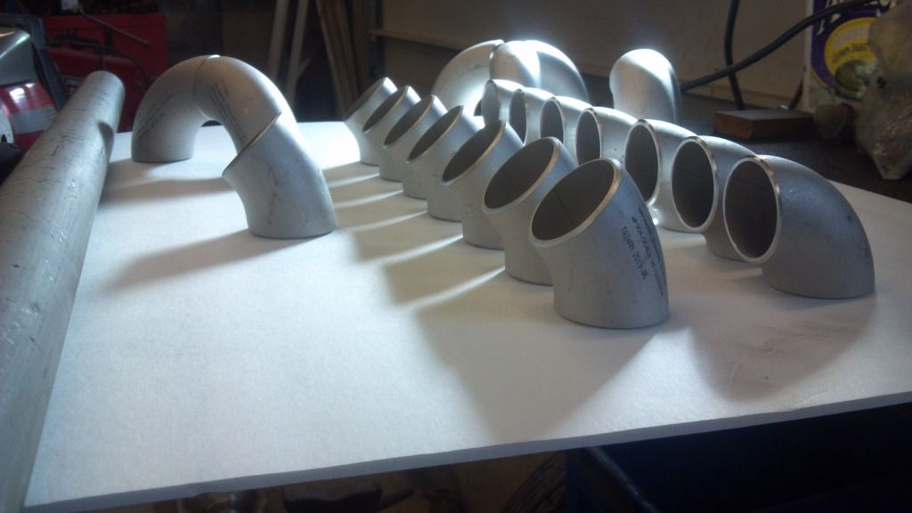

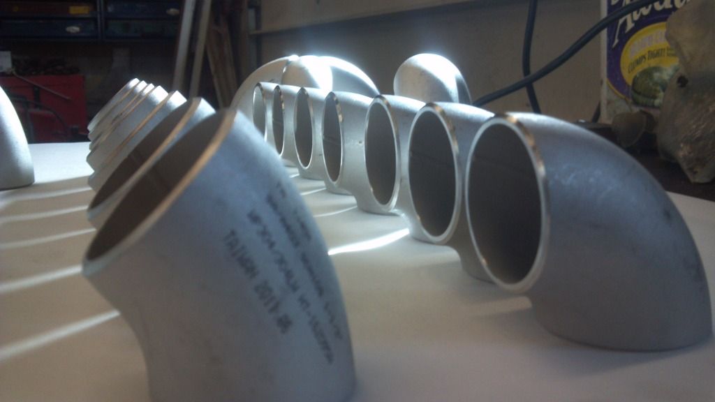

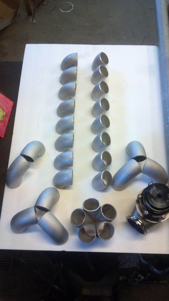

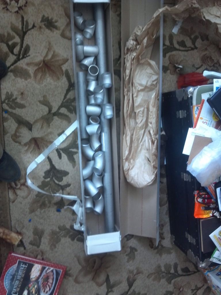

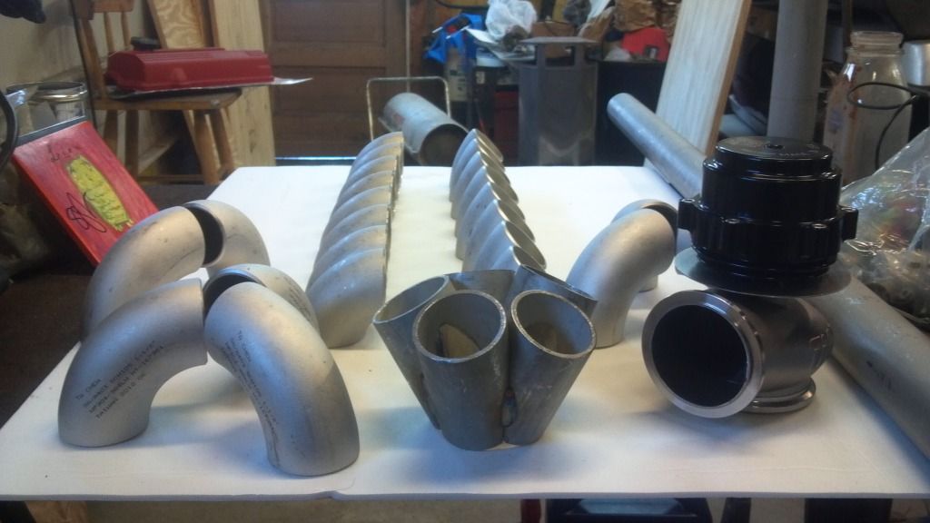

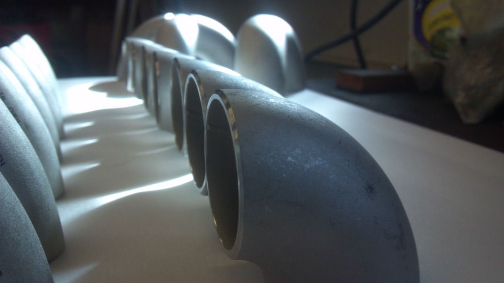

Header Materials
glibobbo21
Posts: 659
Joined: Feb 27, 2013
Re: Jim 07K 84 Super HX40 4kq Header materials
Postby Hank » Thu Mar 14, 2013 6:04 pm

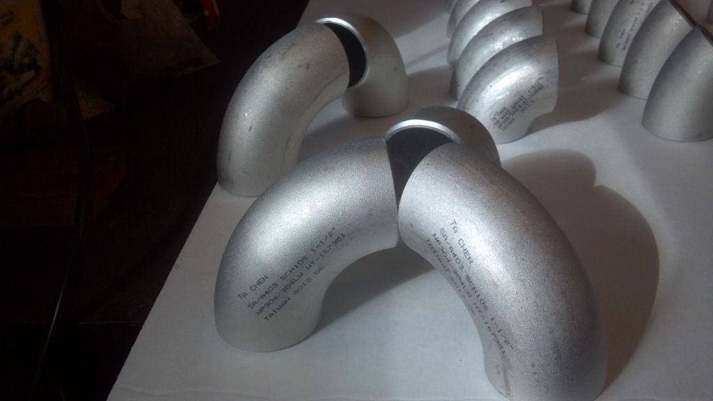

Can't believe you sprung for the short radius 90s! They are such a ripoff!! the 45s too! I find myself just cutting the 90s in half.
Marc should have your collector by now.
Hank
Posts: 1718
Joined: Feb 26, 2013
Postby glibobbo21 » Thu Mar 14, 2013 6:27 pm
Its true but itll be easier and ill build more headers later and theyll come in handy..all that was like 280$. Not bad for more than enough for one header. cant imagine what they pay for them from Taiwan.

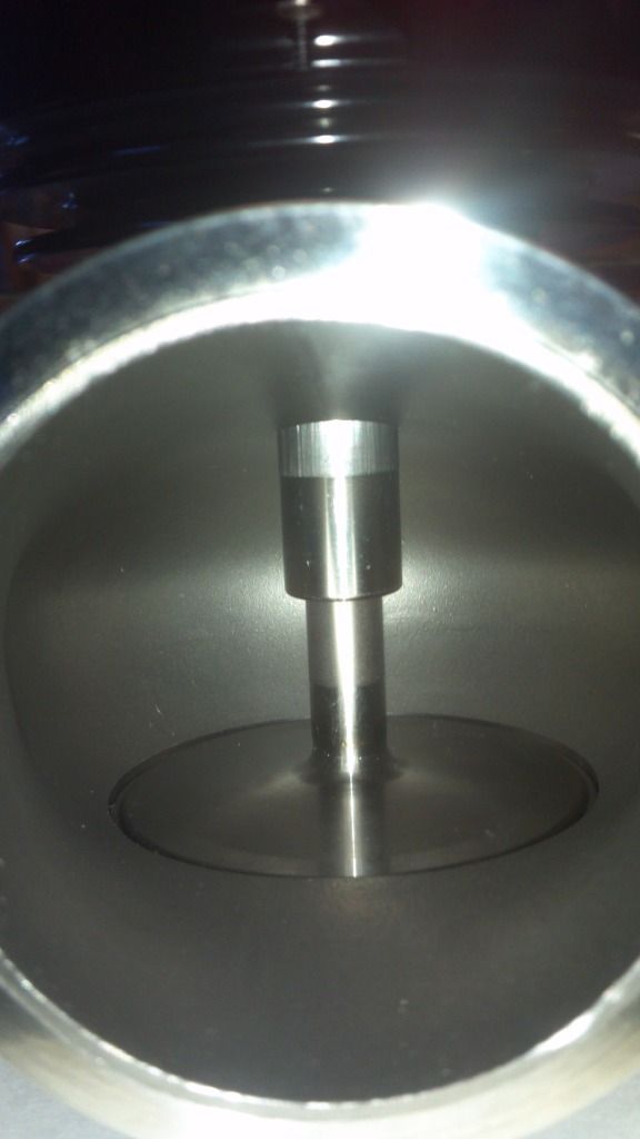

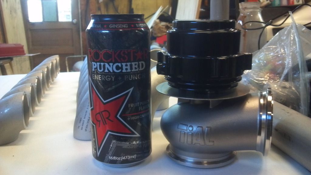

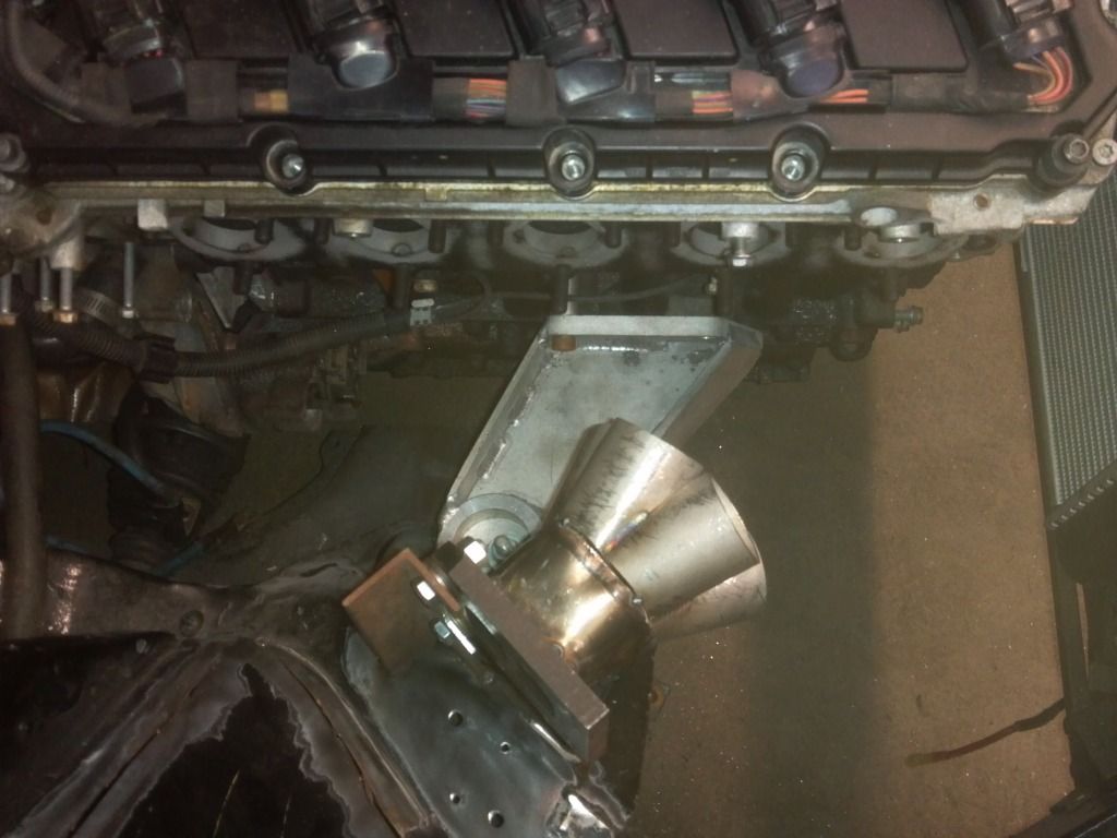

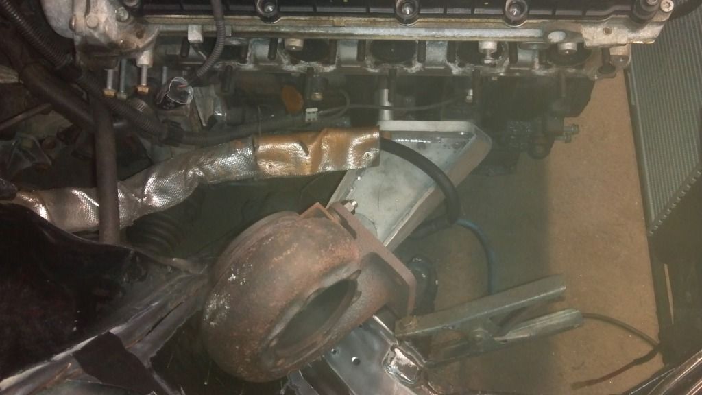

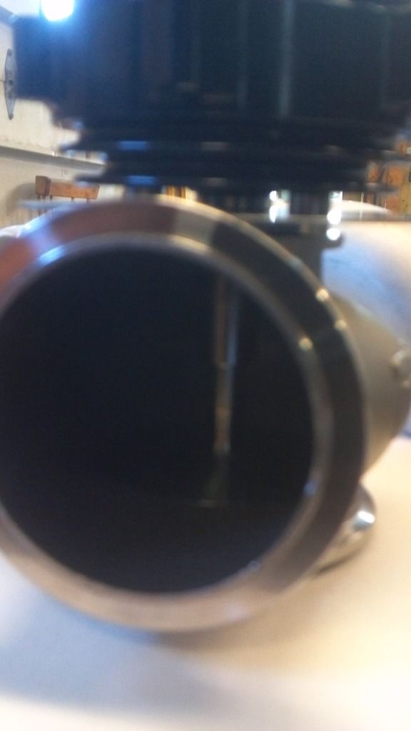

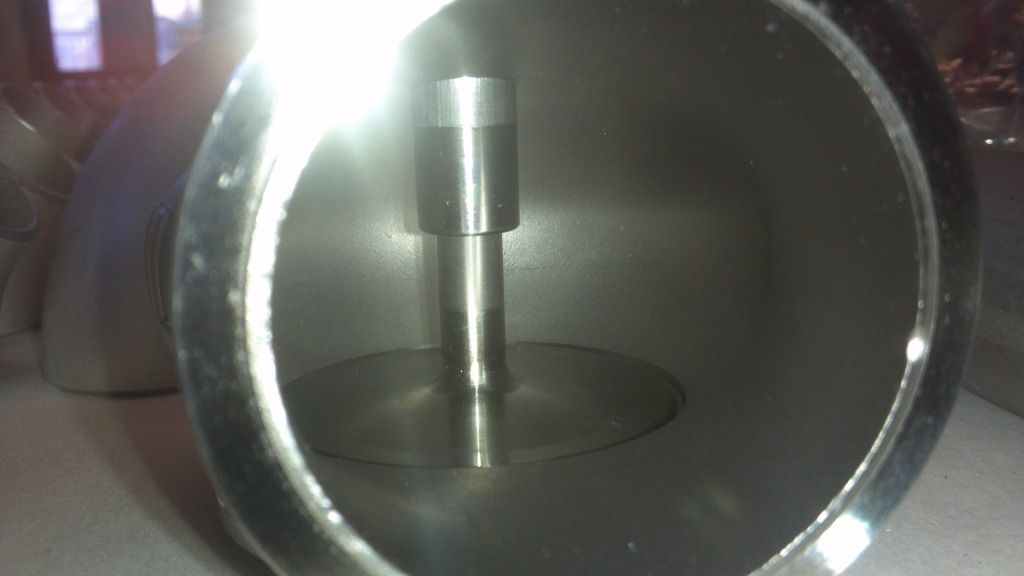

Postby glibobbo21 » Sun Mar 17, 2013 8:10 pm

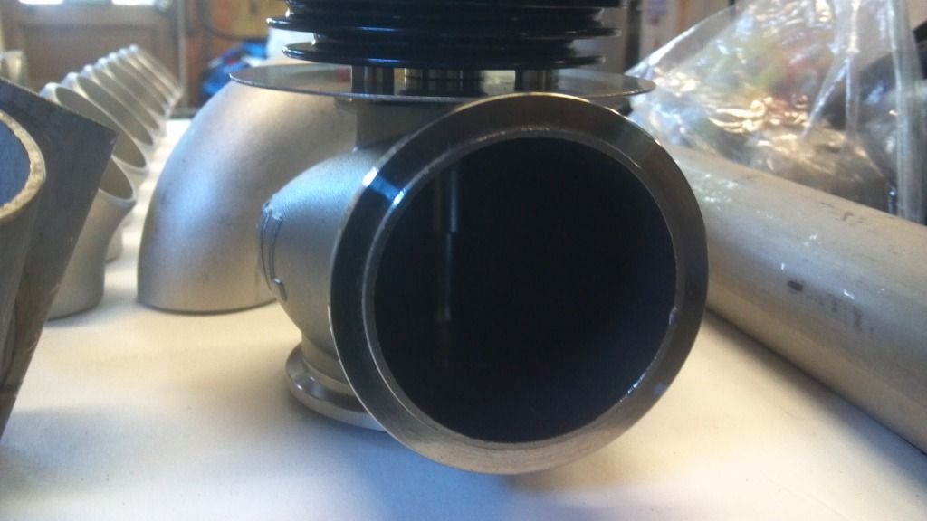

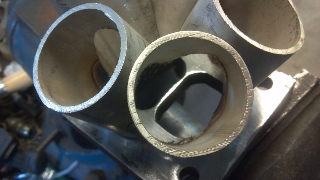

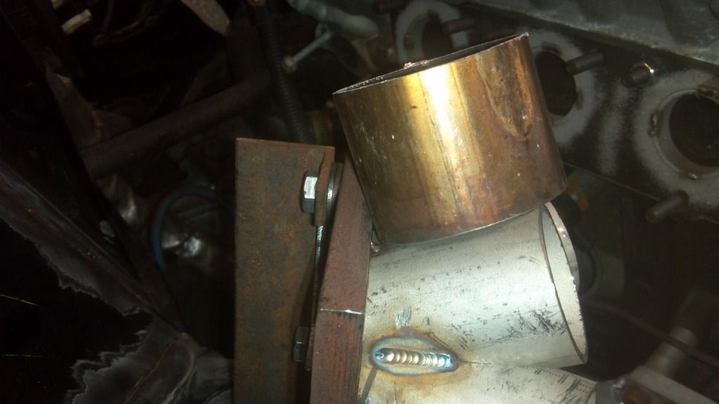

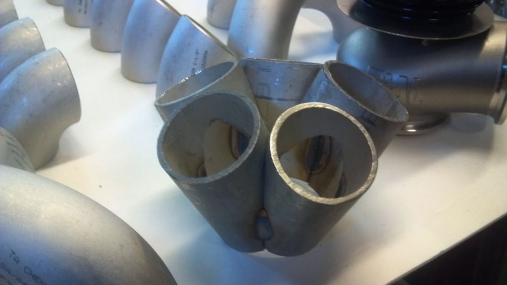

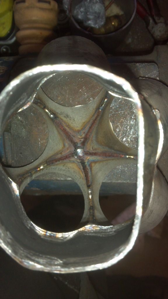

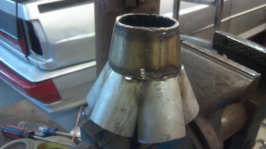

the v60 WG will be a challenge. Its already started to be. The inlet pipe is a 2.5 vband(2.5 pipe) damn, i knew before but when u see it.....DAMN. Turns out hanks collector when shortened to fit, only has space for a 2" wg pipe. So I'll be extending the collector I suppose, oh well.
glibobbo21
Posts: 659

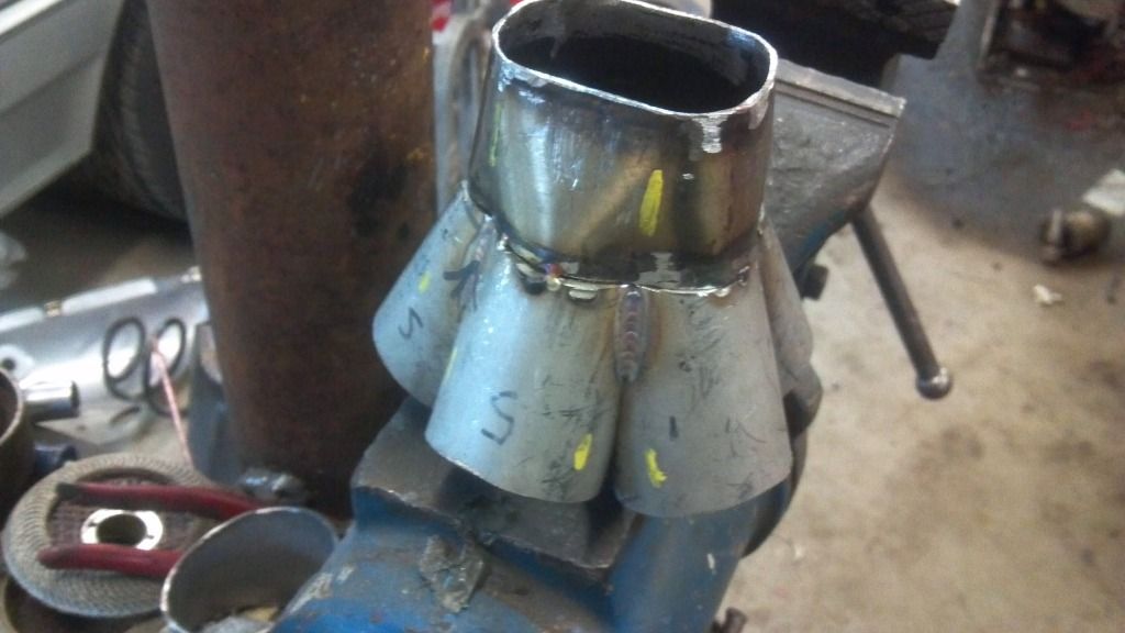

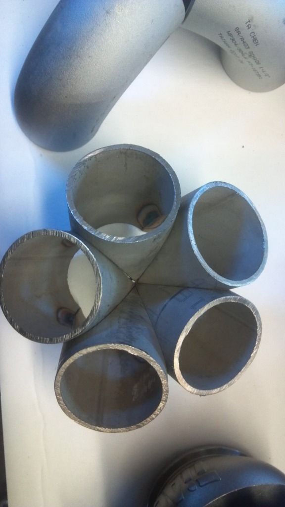

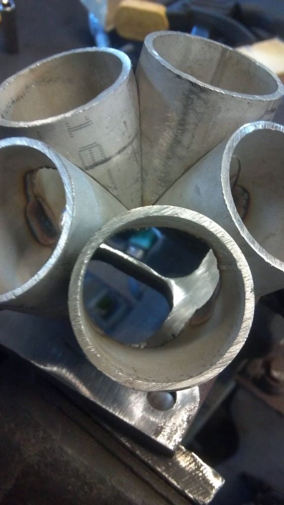

Postby glibobbo21 » Tue Mar 19, 2013 6:55 pm

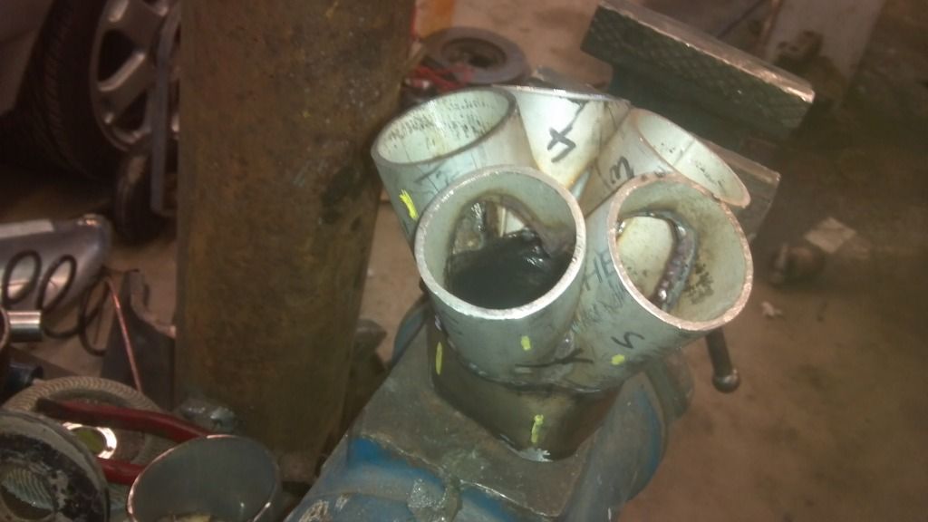

this was the prob. After the collector was modded to fit on the flanmge it was too short to house a 2.5 pipe for the v60 wg. Sooo
challenge overcome...
lengthen the collector(unfortunately)
placement planned
lengthened collector
back on the fixture
It is tight but we'll manage, and have a plan already so..
the offender. For the record, it is shorter than an audi WG by a good 3/4 of an inch.
new version of collector(needs a bit more flange work to fit),welded collector inside.
The last pics the bumps were made nicer then those first couple. Its a pretty smooth transition now.
