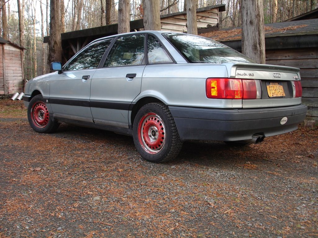

I'm going into my third winter with this car. I put Firestone Winterforce tires on this time and they have excellent dry road manners up to 70mph. I've used Nokias for years but they're pricey. The Firestones have a heavier casing than the Altimax Artics I have on the Jetta. They seem less sloppy and are quieter as well. The after-glow timer for the glow plugs is working great. I've stopped pursuing the mileage quest since I ran out of fuel 2x on the way to work. I fell short of a 900 mile tank. I had been pushing every one to the very bottom of reserve. I set the IP timing back to .90mm because I just have to mess with it and it's been a while.

Lol I can't believe that paint is still hanging on those wheels....
Re: Rich's '91 80Q M-TDI
PostPosted: Thu Dec 10, 2015 7:35 pm
by oil_me
scubagli wrote:Lol I can't believe that paint is still hanging on those wheels....
Each wheel is a numbered piece; it's a fair representation of the early period of the artist. That's what I was told anyway. :lol:

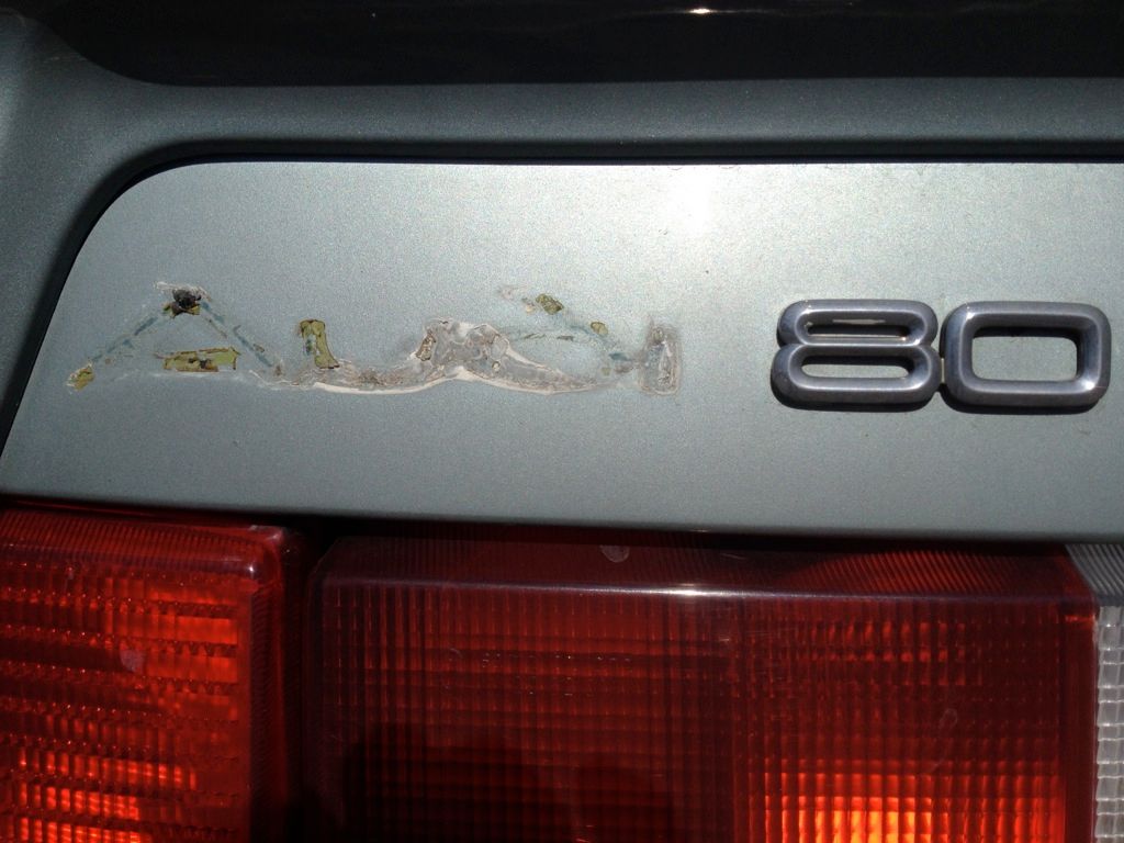

I need an Audi trunk script if anyone has an extra.
PostPosted: Sat Apr 16, 2016 7:14 pm
by scubagli
I think I've got some Rich.
PostPosted: Sat Apr 16, 2016 7:56 pm
by oil_me
Good, that makes it simple.
