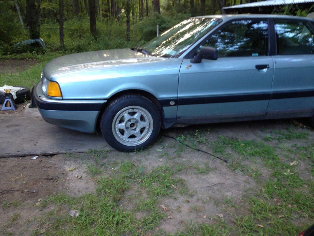

Postby DE80q » Sun Aug 24, 2014 6:33 am
I know the feeling all too well. After all the time and effort I put into my 80q, I just want to drive it. At least I have the replacment trans in hand now.
Maybe I missed it, but what size tires did you put on the speedlines? They look pretty big.

Postby oil_me » Sun Aug 24, 2014 7:39 am
185/60 x 15"; 877 revs per mile and 23.7" overall diameter. I use narrower tires as I have a manual rack. I would prefer to use wheels that aren't so wide but these are what I had. One of the wheels came up slightly bent so I put it on the RR. I hope it won't be an issue. I may get steelies for winter if the set my buddy has, fits. I noticed when I was driving it around; there seemed to be more caster as the steering wheel returned to center more easily. The Bentley says 1º more for the Coupe than the sedan. Hmmm.

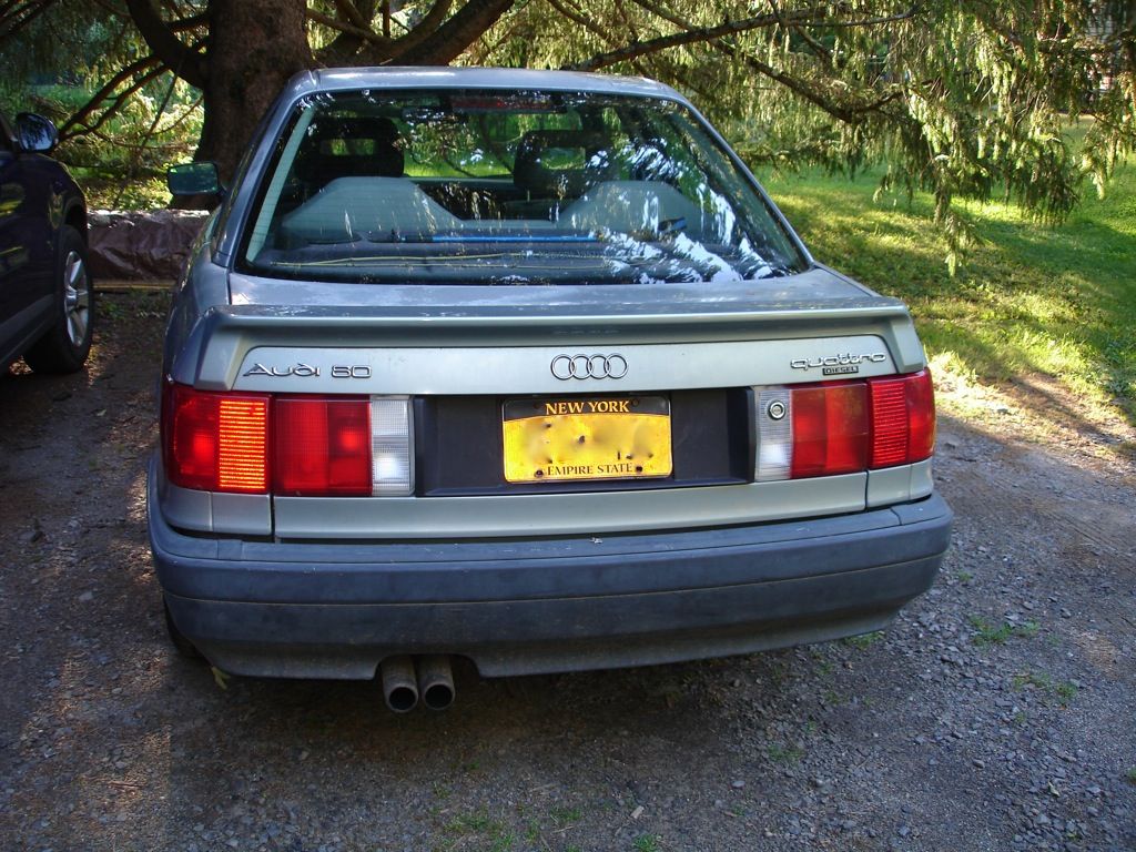

Postby oil_me » Sun Sep 07, 2014 3:41 pm
Back on the road.

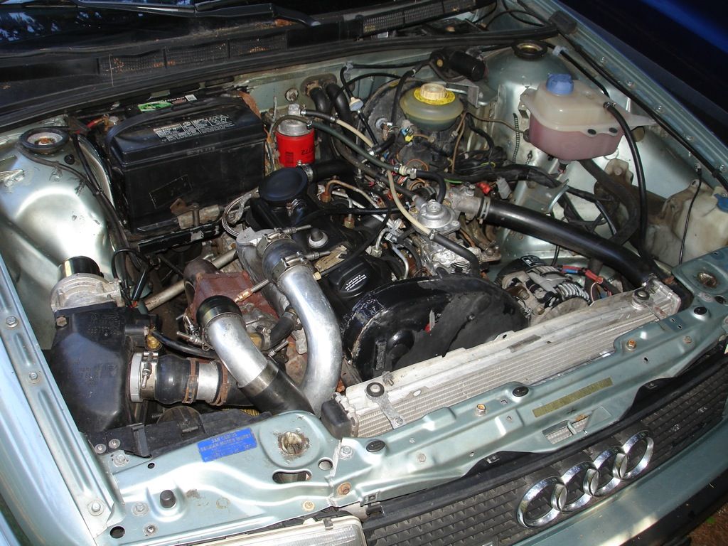

Postby oil_me » Sun Sep 14, 2014 8:24 am
I got the idea from a fellow 'Geek to make a list of cars & parts that make up my 80Q TDI. Here's what I have so far:
80 vw dasher fuel filter flange
83 audi Urq rear diff
84 vw rabbit gti "golf ball" shifter knob
87 vw fox steering rack
88 audi 80 4 cylinder radiator, front rad mount, bumper, sub-frame mounts
89 audi 80 diesel engine mounts (euro)
90 audi coupe q front hubs + brakes
90 coupe wheels
91 vw jetta eco-diesel exhaust manifold
91 audi 80q body
92 audi 90 manual window reg (euro)
93 audi 90 seats
93 audi c5 axle parts (custom rear axles)
94 vw golf k14 turbo (Canada)
94 audi 90 tdi downpipe (euro)
94 s2 steering wheel
95 audi 90 fr. driveshafts
96 vw passat tdi various engine parts
96 vw G/J DGW gearbox (Netherlands)
96 vw LT DI injection pump
98 vw G/J AHU tdi engine block (Canada)
99 vw jetta tdi intake
99 audi a4 tdi starter
2000 audi a4 oil filter flange
96 Mercedes steering damper
