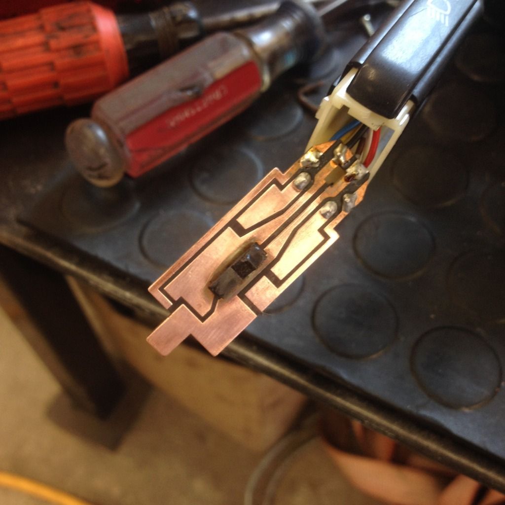

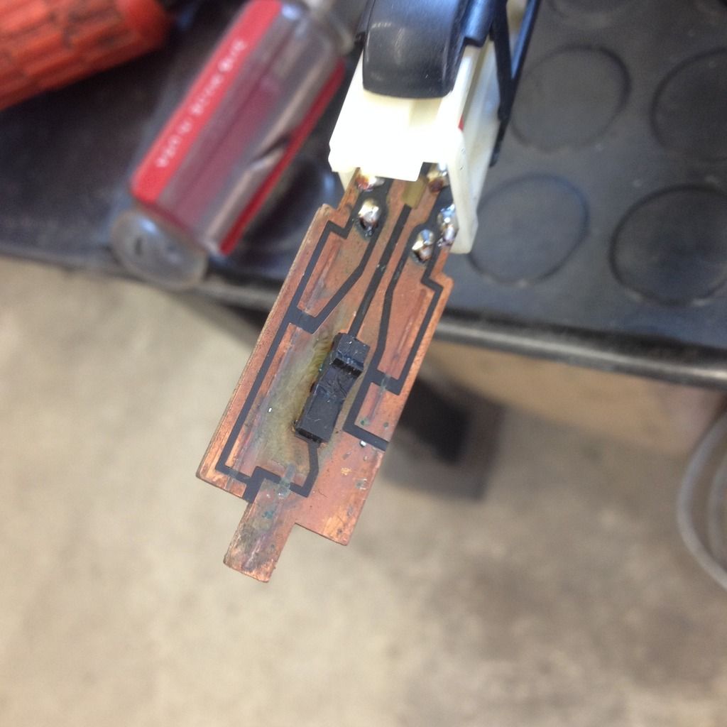

loxxrider wrote:Oh ok. I wonder what the system is like in a t44. It's something I've been planning on fixing eventually, but havent had the time to look into it at all.
I bet its the same thing. I have found that the electrical contacts in the stalk have almost always been corroded to the point of not sending any outputs anymore. The stalk gets switched 12v in and it sends 12v out on 3 different wires.
-12v out for "cruise on" this remains constantly energized when switch is in the on position
-12v momentary out when the set button is pushed
-12v momentary out when the resume button is pushed
These are what my contacts looked like before Image
after

Re: Jim Green's 90q 20vt - 636whp 07k
Good info, I am always surprised mine still works by just hooking up the vacuum hose to the actuator.

audifreakjim wrote:Good info, I am always surprised mine still works by just hooking up the vacuum hose to the actuator.
probably because you live/lived in dryer climates? mine usually just need that corrosion cleaned off and they work again. Everything corrodes around here, too much moisture.
