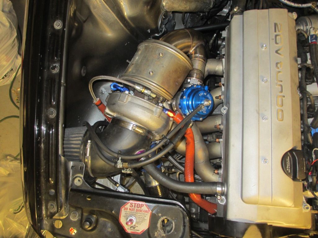

484whp and 440wtq is presenting a whole new set of issues and challenges for my car. The first and foremost is the amount of oil coming from the block and head that is being routed through the Provent 200 catch can. Some research has revealed that that catch can is good to about 250hp. Well I believe 484whp is a lot more than 250hp so it just can't keep up with the pressure and filtering needs. I have the outlet of the OCC going to pre-turbo as to keep the fumes down in the car. There are some decent diesel OCC setups that are capable of pressure in the 500hp range. The Racor 4500 seems to be an interesting option.

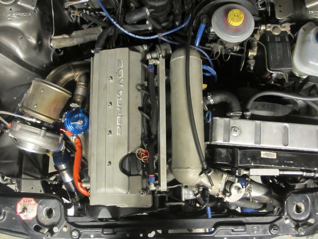

Here is the setup back to the air intake. I'm thinking the turbo is sucking more from the OCC than it is through my filter.
This is the best picture I have of the current setup. Block and valve cover connect and go into the inlet of the provent. Outlet routes to turbo. Oil drains back to block.
I'm contemplating routing the block into the head, then just have a single line from the valve cover to the OCC. But will the pressure push oil out of the valve cover gasket at a weak point. I know there are solutions out there and to each their own, but I now need one.

hmmm, a few things, how can a catch can be rated in HP?!?!
if you think there is less resistance through the OCC line vs the air intake filter, could you run a larger filter?
something seems a bit fishy, theres a lot of cars running the Mann ProVent making more power without much issue.
the motor isn't a junk yard pull, its all fresh rings, valve seals etc so there really shouldn't be a lot of work for the catch can to do.
there shouldn't be much for fumes from the can if the motor is fresh, vs lots of fumes in an older, high mileage motor
I think youd be fine venting it atmosphere and that would take care of a lot of the issues

Don't know how it can be rated, but if you read up on them they are. According to the manufacturer anyway.
https://www.mann-hummel.com/fileadmin/u ... n_2013.pdf
The motor isn't a junkyard motor. The pistons however are 3b stock with upgraded everything else around them. Rods, mains, etc. Compression was good on all 5 cylinders. The head is built with supertech valves, retainers, valve springs. My filter on my Provent 200 is pretty full, so I ordered a new one to give that a try first.

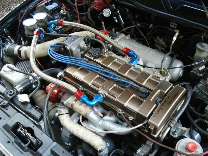

All of my high power Honda friends (this one is now 600whp, picture is a bit old but the venting is the same) run a vented catchcan with lots of VC venting.

Any objections to routing the block breather into the head and then 2 lines coming off the valve cover into a catch can?

I think it would be ok; assuming that you are not getting a ton of blow-by (as noted your engine is fresh). Let's not forget that they are connected by the oil drains but an external connection will not hurt. That said, I like the idea of dual cans ( • )( • )Audilard wrote:Any objections to routing the block breather into the head and then 2 lines coming off the valve cover into a catch can?

What do you mean how can a catch can be rated in HP? Do some math of lead down vs hp. If a healthy engine is leaking down 5%(very normal and healthy) that is 5% of overall hp is getting into the crankcase. On 500whp, that is 25whp worth of air. That is basically what a stock supermotard 250cc WR250x makes. I have stood behind that motor on a dyno, and that is a shit ton of air. Also, a .5" feeder hose, or a small element is not big enough, not on a 250cc bike, or on a catch can. I think most would be surprised of how much their crank cases are being pressurized if they had a sensor monitoring that pressure.
This is why higher hp cars need lots of venting like what you see above from Alex. In the i5, the pickup off the back of the block is an awful blow hole that just pushes oil up into the catch can. The best way to vent them is by pulling off the valve cover between cam lobes with some sort of deflector, preferably in the front of the engine as to not get all the rearward slosh of oil. That 25whp worth of air has to go somewhere, so if it is being forced into the "vent" with a lot of oil, it is going to make a catch can's life a million times harder.
