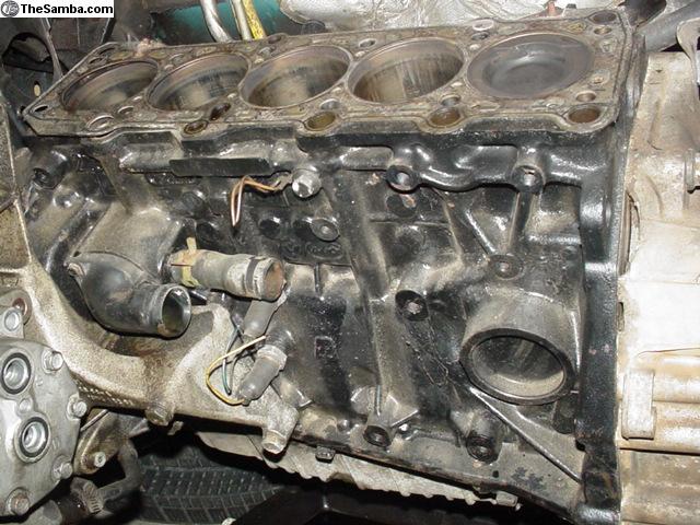

The facts: "Eurospec" 2.6L rally shortblock 82.5x 95.5
I verified the bore and stroke before installing.
Looking at my old 2.3 NF block side by side there are many difffernces:
subtle increase in strengthening ribs on both sides
looks like the lower half of the block is wider (like a VW bubble block), to clear the 95.5 crank
passenger side of the block has "channels" cast to add clearance for the crank throws, you can see them on the outside as raised sections under the strengthening ribs.
I can't remember the deck height, I might be able to measure it in the car.
Deck height is taller because I can barely fit the timing belt with the water pump adjusted all the way out.
It clearly DOES NOT have "2.5L" stamped on the side like the eurovan blocks have...
Pics for reference (black is 2.6, blue is 2.3):

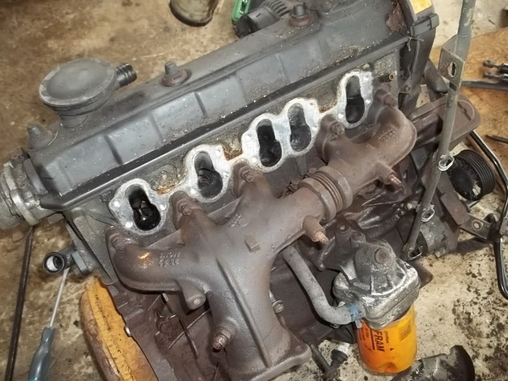

Your deck height is probably 236mm. The blocks that came with the 95.5mm crank were used in the T4 van. Petrol was 2.5L (AAT). There are a bunch of AATs over here.
However, your block is most likely a VW 2.4L diesel block because it came with oil squirters. The petrol versions did not have oil squirters. They can be machined in, but that can be expensive.

I've seen diesel blocks and this isn't one of them, diesel's have the skirts almost touch the main caps, there is a ton more material on the bottom of the block. Years ago, a guy on Motorgeek posted side by side pics of a 2.3 and the diesel block, you could clearly see the difference!
My block has oil squirters because Eurospec installed them, they also bored it out to 82.5mm, as far as I know, no "2.5L" blocks came stock w/ a 82.5mm bore, they were either 81 or 79.5 (diesel).
I found a pic, 1st is a diesel, the others are my Eurospec block.
I'm also trying to figure out if these are stock VW pistons, or are custom made....

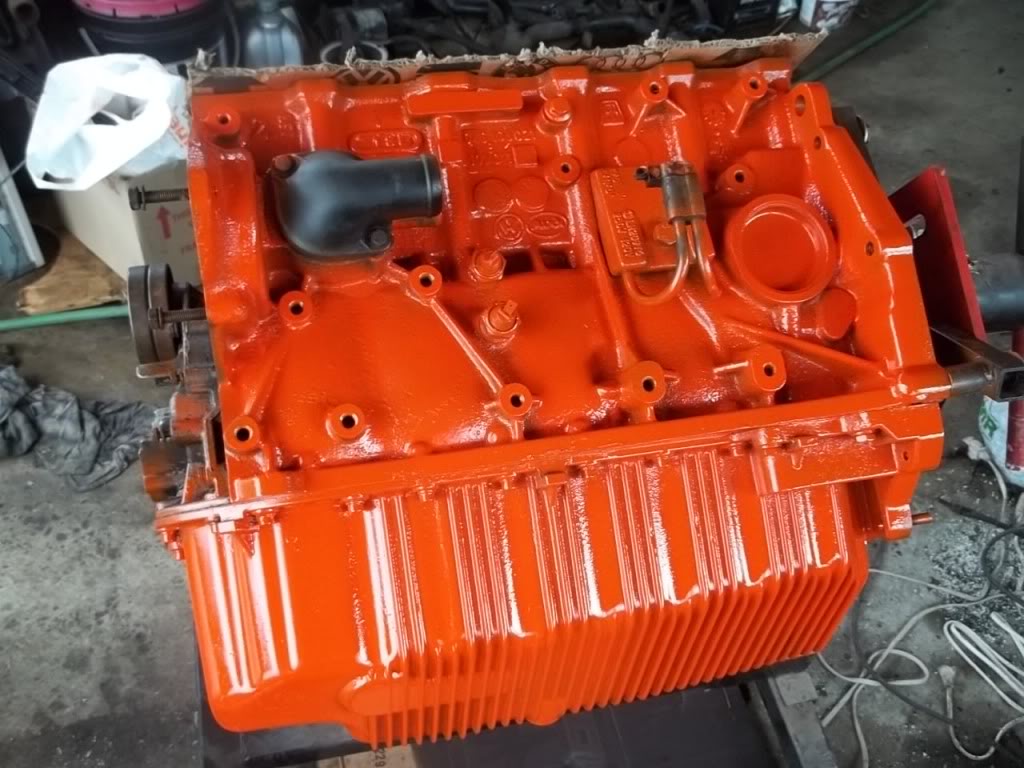

If it's not a diesel block, then it might be a special version of the petrol block. You said Eurospec installed the squirters. The bulges are puzzling. Your pistons might be 9As.
BTW, I fucked up. Petrol 2.5L engine is AAF (later ACU). Not AAT.
Some pics I have of petrol 2.5L.
EDIT: found this: http://forums.vwvortex.com/showthread.p ... viewfull=1
